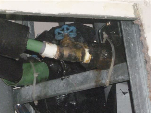

torridtiger Posted June 30, 2013 Report Share Posted June 30, 2013 I am in the mold removal and control business in Costa Rica. I am from Minnesota but got to old for the cold. I know very little about plumbing or a/c units. I just ran into seperated joints on the a/c water pipes in the picture. Can these color, type, pipes be used together for roof mounted chiller a/c units.? This is an 8 storey high rise condo project. Is this something that a special glue could be required? In Costa Rica anything goes and I want to help the builders get things right. They had a huge flood from the 8th floor to the 1 st floor because of this leak. This pipe is either the cold water supply line or return line to the roof mounted units. Thanks for the help. Click to Enlarge 43.45 KB Quote Link to comment Share on other sites More sharing options...
Mark P Posted June 30, 2013 Report Share Posted June 30, 2013 The only green pipe I even seen is a garden hose. Does it feel like a garden hose or is it hard like a pipe? Quote Link to comment Share on other sites More sharing options...

John Kogel Posted July 1, 2013 Report Share Posted July 1, 2013 We are not familiar with the green pipe you say is PVC. Best practice would be to replumb the entire pipe run with copper. Why tempt disaster twice in a row? In condo units here, plastic drain pipe, ABS or PVC, is not allowed, because fire can spread between floors by way of a burning drain stack. So there's a second reason to upgrade the plumbing. Quote Link to comment Share on other sites More sharing options...
inspector57 Posted July 2, 2013 Report Share Posted July 2, 2013 That looks like the green pipe used for gas distribution lines outside underground, not sure if it is PVC. Quote Link to comment Share on other sites More sharing options...
Bill Kibbel Posted July 2, 2013 Report Share Posted July 2, 2013 The only tubing I've seen in that size and color is low-density polyethylene. It's used primarily for pneumatics and beverage applications. Compression fittings only. Quote Link to comment Share on other sites More sharing options...
