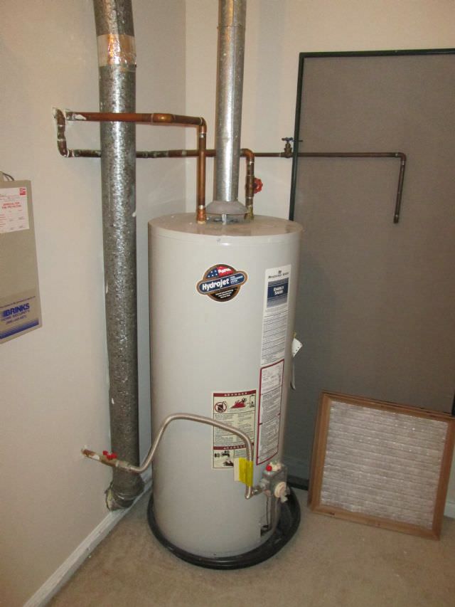

Here is a unique situation regarding a water heater, natural gas supplied, natural draft with combustion air supplied via a duct from the large, vented attic. 1996 townhouse and this is the original water heater.
There is a closet in the bedroom, at the rear of this closet is a second closet in which the tank is located. This closet is not a dedicated enclosure as the entry door is not fire rated or self closing. I don't know the rating of the wallboard. It is definately a storage closet, not a utility area. How is it that this was approved by the AHJ, it likely exists in all of the other units (over 50 t-houses)? Opinions?

The plastic drain pan under the cold water heater is not approved for a gas fired unit.
Most '96 era cold water heaters have a defective dip tube. What was the hot water temperature after running the dishwasher? Lukewarm I bet. Was the cold water heater thermostat set to "High"? Probably. Will it leak one or two weeks after the new owners move in? Probably.

Ditto plastic pan and where does it drain to or does it have a wet alarm?
No sediment trap on gas line
Where is this MUA duct? What is the BTU/hr input rating-40K?
Any pics of the vent connector attachment to the B-vent at the ceiling?
Are there any screws on those connector joints?
If residential, not aware of fire rating for the closet as opposed to the separation btw occupancies.
