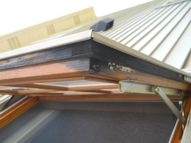

Mike Lamb Posted July 11, 2013 Report Share Posted July 11, 2013 I am having my fill of windows rotting out way before their time. This 15 yr old clad window sash is blackened but is not yet rotting. There are a couple more like it. I am going to recommend that it be cleaned and weather sealed but is this going to actually help in any way? I am beginning to think that wood windows with exterior cladding is an extremely bad investment no matter what the brand of window. Click to Enlarge 37.94 KB Quote Link to comment Share on other sites More sharing options...
hausdok Posted July 11, 2013 Report Share Posted July 11, 2013 Waste of time and money to clean and seal. There is incipient rot in the wood already. If there is enough meat on the bone with those sashes you could try Impel Rods but installing them means drilling holes into the sash from the inside and then filling, sanding and finishing the holes once the rods are inserted. ONE TEAM - ONE FIGHT!!! Mike Quote Link to comment Share on other sites More sharing options...
kurt Posted July 11, 2013 Report Share Posted July 11, 2013 Boy, I don't know about that. I've fixed stuff way worse than that with epoxy applications; get a thinned out epoxy, saturate the area, incipient rot goes bye bye in a haze of toxic polymerization. That window needs something fast, but the something it needs isn't complicated or expensive. Doesn't anyone else out there torture themselves with wooden boats? Quote Link to comment Share on other sites More sharing options...
Tom Raymond Posted July 11, 2013 Report Share Posted July 11, 2013 Not any more. I became a home inspector to support my boat building habit. Boy, what was I thinking. That looks like a Crestline-Vetter-Norandex or similar builder grade window. If it's still in production a replacement sash will be only a few bucks more than an Abatron kit, and way less than anything from West. Quote Link to comment Share on other sites More sharing options...

Mike Lamb Posted July 12, 2013 Author Report Share Posted July 12, 2013 They are Cardinal windows or at least Cardinal glazing. The problem with clad windows is how do you treat behind the cladding? The sash may be worse than what you can see. Quote Link to comment Share on other sites More sharing options...
Tom Raymond Posted July 12, 2013 Report Share Posted July 12, 2013 Cardinal manufactures glass and fabricates insulated glass units. They don't make windows. Clad windows are always worse than they look. Quote Link to comment Share on other sites More sharing options...
