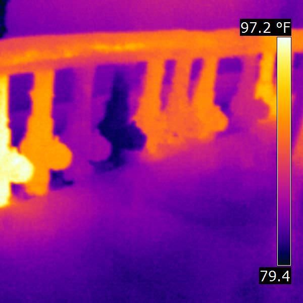

Mark P Posted July 14, 2013 Report Share Posted July 14, 2013 This house is heated by a hot water boiler that circulates the water through pipes in the slab foundation. After running the boiler for around 30 minutes I could see the loops in the floor with my IR camera. Except in the living room, there was no heat at all. Looking at the manifold one of the loops is clearly cold. Every room had heat, except the living room. My questions is: Looking at the manifold, is there a way that the zone could have been closed? If so how? Do you use a screwdriver or is there a handel that is attached... I'm just trying to figure out why only the living room was cold. Click to Enlarge 44.07 KB Click to Enlarge 33.36 KB Quote Link to comment Share on other sites More sharing options...
Stephen Lagueux Posted July 14, 2013 Report Share Posted July 14, 2013 did you check the returns? There could be valves there... Quote Link to comment Share on other sites More sharing options...
kurt Posted July 14, 2013 Report Share Posted July 14, 2013 The shut off is a slot blade screw head inside of the hex locknut. If the slot is parallel with flow, it's open...perpendicular, it's closed (at least, that's how they are here). It could also be the entire loop is shut down due to corrosion and pipe failure. Those copper radiant systems last anywhere from (about) 35 years to 65 years (some maybe longer), but they will fail. Quote Link to comment Share on other sites More sharing options...
David Meiland Posted July 14, 2013 Report Share Posted July 14, 2013 I suppose there's also the possibility that the loop isn't flowing because of an air bubble in it, or an obstruction of some kind. What's the chances of getting those little tiny screwdriver valves to turn easily?? Quote Link to comment Share on other sites More sharing options...
kurt Posted July 14, 2013 Report Share Posted July 14, 2013 What's the chances of getting those little tiny screwdriver valves to turn easily?? Just about zip. Although, I've soaked them in penetrating oil and hit them with a torch and got them to move. Quote Link to comment Share on other sites More sharing options...
Mark P Posted July 14, 2013 Author Report Share Posted July 14, 2013 These were the only valves and I was not about to turn any of them - no way. Thanks Kurt that was helpful. At this point I'm just going to report what did, what I discovered and tell them I don't know why there is no floor heat in that room. I'll punt to a company that has experience serviceing and maintaining these system. Most days I don't find anything with my IR, but sometimes it earns its keep. Quote Link to comment Share on other sites More sharing options...
kurt Posted July 14, 2013 Report Share Posted July 14, 2013 That's what I'd do. I have often asked the customer or realtor to tell me what the tech finds when they service it; it's good education. Quote Link to comment Share on other sites More sharing options...
Rob Amaral Posted July 15, 2013 Report Share Posted July 15, 2013 copper embedded into concrete directly = corrosion=leakage=air-entrainment=air-bound.. (Maybe).. (Air entrains during cold period... builds-up.. no movement). A 'pressure test' of that zone can be done to isolate the problem.. and then give them the heads of the downside of copper-in-direct-contact-with-concrete (=potential leakage, air-binding and over-working of the boiler). We have thousands of these systems from the 1950's around Boston area and they are mostly being upgraded to above-slab systems by now.. Quote Link to comment Share on other sites More sharing options...

John Kogel Posted July 16, 2013 Report Share Posted July 16, 2013 Two degrees in 2 hours is normal here for hydronic on a concrete slab. I do the same thing you did, watch for a response to the thermostat, then check for a working circulation pump and a gradual rise in temp. A house with 4 or 5 zones, there's not enough time in the day to check the system thoroughly, which is what I tell the clients. "It makes heat, but I can't tell you how much for how long". Quote Link to comment Share on other sites More sharing options...
Mark P Posted July 25, 2013 Author Report Share Posted July 25, 2013 So I asked the realtor what happened with this. She said they had an HVAC company come out and they said everything was working normally. I suspect the HVAC company did not see my report or pictures. I suspect they came out and fired up the boiler, checked the pump, etc and said it is working fine. I suspect they were not told what the specific problem was. Kinda gets my hackles all worked up. Quote Link to comment Share on other sites More sharing options...
kurt Posted July 25, 2013 Report Share Posted July 25, 2013 Of course they weren't. Sounds par for the course when realtors are in charge or following up. Quote Link to comment Share on other sites More sharing options...
