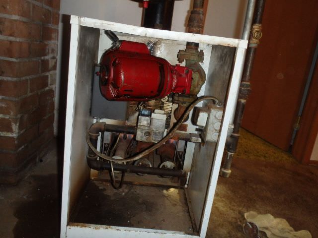

mridgeelk Posted July 18, 2013 Report Share Posted July 18, 2013 How old is a Peerless Furnace MM2 21554 with no model number. Thanks, Ed Click to Enlarge 49.04 KB Quote Link to comment Share on other sites More sharing options...
Tom Raymond Posted July 18, 2013 Report Share Posted July 18, 2013 They still make a couple M series boilers but I couldn't find any MM series info. This company history narrows it down a little (emphasis mine): Peerless Boilers Company Evolution 1908 - Peerless Boilers is founded in Boyertown, Pennsylvania 2006 - Peerless Boilers introduces the new Series PSCII gas-fired, direct vent, sealed combustion boiler for residential applications 2007 - Peerless Boilers Department of Applied Technology is formed to focus on developing new heating technologies Today - Peerless Boilers manufactures a broad range of high quality boilers and indirect-fired hot water heaters for residential and commercial / industrial applications Quote Link to comment Share on other sites More sharing options...
Bill Kibbel Posted July 18, 2013 Report Share Posted July 18, 2013 It's a boiler, not a furnace and it's leaning to the right. Pre 1984, Peerless did not use a date code. From 1984 to 1999, the serial number ends with for digits. 123456-1092 would be Oct. 1992. Since 2000, the serial number ends with 6 digits. The first four of the ending 6 digits is the year. 123456-200206 would be June 2002. The auto gas valve has an ink stamp with the date. Compare that to the numbers on the PRV valve handle or tag. One of them would likely be original. Quote Link to comment Share on other sites More sharing options...
mridgeelk Posted July 18, 2013 Author Report Share Posted July 18, 2013 Thanks for the correction and I was leaning to the left, something that I occasionally do. It's a boiler, not a furnace and it's leaning to the right. Pre 1984, Peerless did not use a date code. From 1984 to 1999, the serial number ends with for digits. 123456-1092 would be Oct. 1992. Since 2000, the serial number ends with 6 digits. The first four of the ending 6 digits is the year. 123456-200206 would be June 2002. The auto gas valve has an ink stamp with the date. Compare that to the numbers on the PRV valve handle or tag. One of them would likely be original. Quote Link to comment Share on other sites More sharing options...
mridgeelk Posted July 22, 2013 Author Report Share Posted July 22, 2013 According to Peerless the unit was made in 1967. Quote Link to comment Share on other sites More sharing options...
