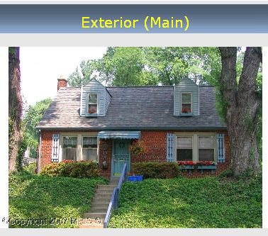

oatmealeater Posted August 26, 2013 Report Share Posted August 26, 2013 UPDATE: I wanted to post an update because I received so many helpful responses from all of you. We had an arborist out to look at the trees. There are a few serious wounds in one tree, but they are both still solid and healthy i.e. not a threat to our house. We arranged to have some nutrient treatments applied and she will be back every year to have a look at them. Also, she assured me that when the tree with the serious wounds in it does need to be brought down, there are many options for planting other trees around the site to keep erosion and other land issues at bay. I feel much less fearful about the whole issue now and that has made me realize that I really love those trees! They bring a lot of shade to our whole house and they are just really beautiful. So, thanks, everyone, for helping to allay my fears and for urging me to get an arborist out stat. Original message follows: Hello, I apologize for the long entry here and lack of any technical understanding, so please bear with me as I explain my dilemma: Our house was built in 1947. We've lived in it since 2008. It's a nice little cape cod right outside of DC. There are two very big, very tall red maple trees that were probably planted when the house was built. They are close to the house (about 4-5 feet from the outside of the house) and very thick, probably about 6 feet around, maybe wider. They give the house a lot of shade, which is nice. There is a big wound in one of the trees, that I was told would eventually be fatal. I am also always worried about these mammoth trees falling on our house during a big storm. And finally, I am worried that if we cut down one or both of the trees (a job that would cost over $10,000, I'm told) the roots would decompose and cause serious damage to the foundation of our house. Right now, there are no large cracks in the outside of the house, the basement is pretty dry, and the unfinished part of the basement also doesn't appear to have any large cracks. My question is this: 1) how likely do you think it is that these trees may have already caused damage to the foundation or structural integrity of the house? 2) Are these trees a huge liability? Should we get the hell out of this house while we're still alive? Click to Enlarge 40.64 KB Quote Link to comment Share on other sites More sharing options...
Robert Jones Posted August 26, 2013 Report Share Posted August 26, 2013 While not an arborist, "eventually fatal" could be quite a long time and allow for you to save up, if need be, to remove the tree(s). From what I have read, each of the species of maples have different root systems. About the foundation. It has been my experience that cracking or heaving would have appeared already if the tree's are that old. There should be some heaving of the walkway's, patio slab etc, if the roots were causing issues. Tree's this large don't necessarily root under a foundation, in some cases, they go right through a basement wall. That would be quite noticeable;) Have you considered hiring a home inspector to have a closer look? My opinion is, yes the tree's are too close to the home, but, doesn't appear or sound like they are causing any structural issues. Quote Link to comment Share on other sites More sharing options...
oatmealeater Posted August 26, 2013 Author Report Share Posted August 26, 2013 Thanks! That is helpful. We do think our foundation is in good shape, but again, we are just laypeople. We did do an inspection in 2008 and it passed. But now we have a child and the issue weighs heavily on my mind. Are there any good home inspection companies in the DC area? I just need some peace of mind. How much would it cost if we just had an inspector come out and look at our foundation? Is this like a $200 job or a $1000 job? Is peace of mind a completely elusive concept when you're talking foundations and trees? Quote Link to comment Share on other sites More sharing options...
SNations Posted August 26, 2013 Report Share Posted August 26, 2013 Don't bother to hire a home inspector to look at your foundation. That will be a huge waste of money. It's pretty clear that your foundation is fine -- at least the part that's visible, and an inspector can't see the rest anyway. Call an arborist if you have concerns. Who told you the tree has a fatal wound? Do you believe that person? Do you want a second opinion? Are there branches that threaten your house? Has this tree stopped growing? Is it at a stage where the roots are done growing and now the tree will either thrive or die? The concerns are primarily with the tree, so call a tree person if you have questions. Quote Link to comment Share on other sites More sharing options...
Welmoed Posted August 26, 2013 Report Share Posted August 26, 2013 The root ball of a tree is usually equal to the drip line. That is, if the leaves and branches of the tree canopy reach out 30 feet from the trunk, the roots will -- or will try to -- reach out the same distance. So if a tree is planted so close to the house that the branches overhang the roof, the roots will be doing their darndest to push that way too, exerting a lot of pressure on the foundation. Once the tree is cut down, this pressure will go away. Decomposing roots shouldn't cause much of a problem. Removing the trees will also help extend the life of the roof. We do inspections in Silver Spring; you're welcome to give our office a call. Quote Link to comment Share on other sites More sharing options...

Marc Posted August 26, 2013 Report Share Posted August 26, 2013 Removing a live tree that big will considerably alter the moisture gradients in the soil in the vicinity of the tree. Moisture levels -and soil elevations - would likely rise once the tree is no longer pulling hundreds of gallons a day from the soil. Greater moisture content can easily lift foundations. Whether the foundation fails depends on whether it can bear those forces or not. Any good arborist can tell you more than I. Marc Quote Link to comment Share on other sites More sharing options...
kurt Posted August 26, 2013 Report Share Posted August 26, 2013 Tree roots really aren't looking for concrete, nor do they necessarily "push" on a foundation without a number of other possible factors that might apply. What roots will do is drink up all that water under the house; trees that large are probably soaking up 300 gallons a day (at least) in the summer. When the soil has all the water pulled out of it, it can subside (settle). Subsidence can cause footing/foundation settlement. But, since nothing is showing, I wouldn't sweat that one either. For all the urban legend talking about trees damaging houses, I've rarely seen it in my career. Maybe a couple times in 25+ years. Sure, it can happen, but so can a lot of things. (Fine print note.....for every home inspector that says it rarely happens, there will be at least one other home inspector insisting it happens all the time.) Call the arborist, see what they say, then come back and share the info. There's no quick slam dunk analysis on this one; it will take a few folks opinions before you know anything for sure. Quote Link to comment Share on other sites More sharing options...
kurt Posted August 26, 2013 Report Share Posted August 26, 2013 The root ball of a tree is usually equal to the drip line. That is, if the leaves and branches of the tree canopy reach out 30 feet from the trunk, the roots will -- or will try to -- reach out the same distance. So if a tree is planted so close to the house that the branches overhang the roof, the roots will be doing their darndest to push that way too, exerting a lot of pressure on the foundation. Once the tree is cut down, this pressure will go away. Decomposing roots shouldn't cause much of a problem. Removing the trees will also help extend the life of the roof. We do inspections in Silver Spring; you're welcome to give our office a call. Hey there Welmoed....welcome to TIJ. Please hang around. We need women to contribute. This place overflows with testosterone.....we could use balance. Quote Link to comment Share on other sites More sharing options...
Bill Kibbel Posted August 26, 2013 Report Share Posted August 26, 2013 "Tree roots extend as far as the branches, so if there are branches over your house, there are roots in/under it" is folklore. Kurt is correct. Roots don't want to fight through concrete to find moisture and nutrients. Michelle, be glad you don't live in my house in the middle of a dense forest. There are at least 30 mature hardwood trees close enough and large enough to destroy my home if any one fell. Quote Link to comment Share on other sites More sharing options...
AHI in AR Posted August 26, 2013 Report Share Posted August 26, 2013 To amplify on what others have said previously, I wouldn't be in a hurry to cut the tree down. After all, it and your house grew up together. And the house isn't showing too many signs of problems, correct? Maple trees can have a much longer lifespan than yours have. If there aren't any signs of problems I wouldn't recommend rocking the boat IF you want to keep the tree. As has been mentioned previously, if you cut the tree down the deterioration of the stump and roots will likely cause far larger problems than you have experienced up to this point. Quote Link to comment Share on other sites More sharing options...

hausdok Posted August 26, 2013 Report Share Posted August 26, 2013 Hi, All good advice but the most important reason that you should call an arborist is that if those trees do come down and you haven't called an arborist to evaluate them there's a good chance your insurance company will not pay you a dime because you didn't exercise "due diligence." That happened to a client of mine about 7 - 8 years ago. She had me inspect the house in October. There were tall trees on the property - about half a dozen. I told her to get them looked at by an arborist and do whatever the arborist said to do by way of pruning, removing etc. She closed in November. In mid-November we had a series of wind storms that took down trees and power lines all over the county and left many of us without power for more than ten days. Not long after that period started, I got a call from my client. She wanted to know if I knew of a tree removal service in the area. I told her of a company I knew and asked what was up. She responded that one of those trees had come down......on top of a neighbor's house. She'd called her insurance company. They asked her if she'd had the trees evaluated by an arborist when she took possession. She had not. She'd leased the house back to the seller for two months and hadn't moved in yet so she hadn't gotten around to getting the trees evaluated. Her insurance company tsk, tsk'd and then told her that there was nothing they could do because as the homeowner she was expected to exercise due diligence and she should have had those trees evaluated. The rest of the story is that she was sued by her neighbor's insurance company to recoup the cost of repairing her neighbor's house and she ended up going bankrupt and her home was foreclosed. Get them looked at. Then do whatever it takes to follow through with the arborist's recommendations as soon as you can. ONE TEAM - ONE FIGHT!!! Mike Quote Link to comment Share on other sites More sharing options...
oatmealeater Posted August 26, 2013 Author Report Share Posted August 26, 2013 Wow, Mike. That is a sobering tale!! Now my husband thinks we should call the insurance company just to make sure we are covering our bases on the due diligence side of things. We have an arborist coming out on Thursday, so I will update you all on what they say. We had been letting these trees go for years without pruning, but now I think we need to take a more responsible approach. Quote Link to comment Share on other sites More sharing options...
