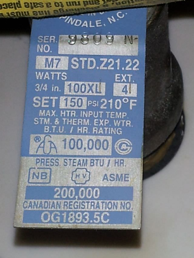

rkenney Posted August 29, 2013 Report Share Posted August 29, 2013 I concur with others that a PRV is really needed, that water pressure is way to high. Here's the tag off my WH TPR. It says set for 150 psi so you would think all the seals and container would hold anything below that. If the true average tank pressure is above your one or two readings and the TPR setting you would expect it to leak there (TPR) first. Best course is to eliminate the pressure problem with a PRV and expansion tank. Click to Enlarge 79.51 KB Quote Link to comment Share on other sites More sharing options...
Hearthman Posted August 29, 2013 Report Share Posted August 29, 2013 That high pressure may already have stressed the water inlet valve on any washing machine or dishwasher so those valves may need to be replaced as may any flexible hoses. Use braided stainless steel jacketed hoses at minimum. You can get FloodSafe hoses that have a high flow shutoff feature. These, however, are made by man and may fail so nothing is 100% bullet proof. The TPR should relieve 150psi or 210degrees F for small residential water heaters. http://media.wattswater.com/F-SF.pdf Quote Link to comment Share on other sites More sharing options...
