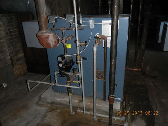

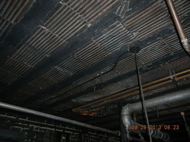

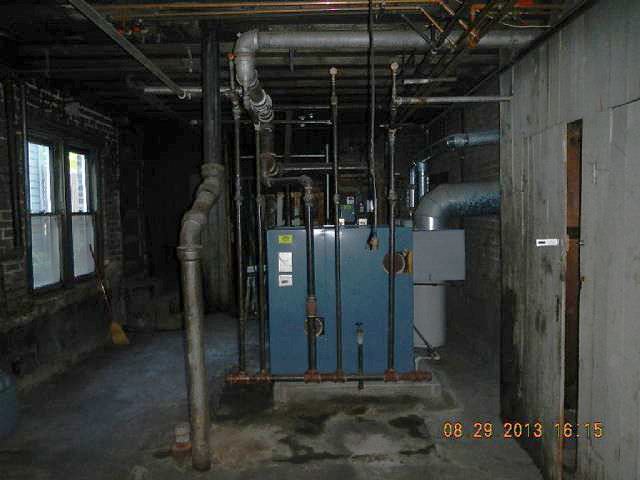

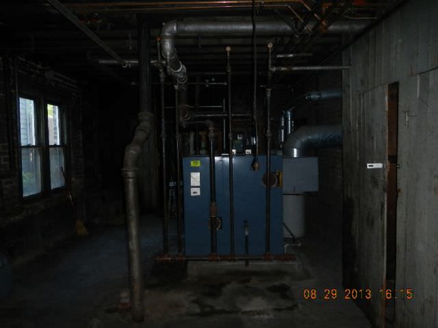

kurt Posted August 29, 2013 Report Share Posted August 29, 2013 I own one. With a steam boiler. And all the pipes and controls. Sill and head skimming, McDonnell valves and drains, A RD1404 series microprocessor control to drag as much efficiency as I can out of it, and no apparent asbestos anywhere. This place is built like a bank. 5 brick thick at bottom, 3 at top (14" coping tile), floor platforms cast coffered concrete & terra cotta, wood floors on sleepers over the concrete. I had to show it off. Click to Enlarge 43.66 KB Click to Enlarge 33.6 KB Click to Enlarge 64.7 KB Click to Enlarge 40.72 KB Quote Link to comment Share on other sites More sharing options...

Chad Fabry Posted August 30, 2013 Report Share Posted August 30, 2013 Robust. Parallel. Sweet. Quote Link to comment Share on other sites More sharing options...
Jim Katen Posted August 30, 2013 Report Share Posted August 30, 2013 It looks much cleaner and tidier than similar stuff that I tend to see. Circa??? Quote Link to comment Share on other sites More sharing options...
kurt Posted August 30, 2013 Author Report Share Posted August 30, 2013 1929. Boiler is about '98-99, and in remarkable condition. The pipefitting is exceptional. Quote Link to comment Share on other sites More sharing options...

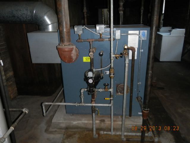

hausdok Posted August 30, 2013 Report Share Posted August 30, 2013 Don't know how that looks to others but from here that place is dark as the inside of a cat's ass and it's hard to make out what I'm seeing. For the benefit of you other old farts with browsers that make that all dark and dreary, I've tried to lighten the photo so one can see some detail. Click to Enlarge 46.1 KB OT - OF!!! M. Quote Link to comment Share on other sites More sharing options...

Neal Lewis Posted August 30, 2013 Report Share Posted August 30, 2013 Kurt, no pigtails on the pressuretrols? Where is the glass gauge? Quote Link to comment Share on other sites More sharing options...
Rob Amaral Posted August 30, 2013 Report Share Posted August 30, 2013 el no insulato el pipes-o? Quote Link to comment Share on other sites More sharing options...
kurt Posted August 31, 2013 Author Report Share Posted August 31, 2013 Don't need pigtails. Urban folklore. Sight glass is behind a pipe. Don't necessarily need insulation either in a flat out solid masonry building. Floor platforms, walls, and ceilings kinda go radiant. It may be the best balanced system I've encountered. Quote Link to comment Share on other sites More sharing options...
