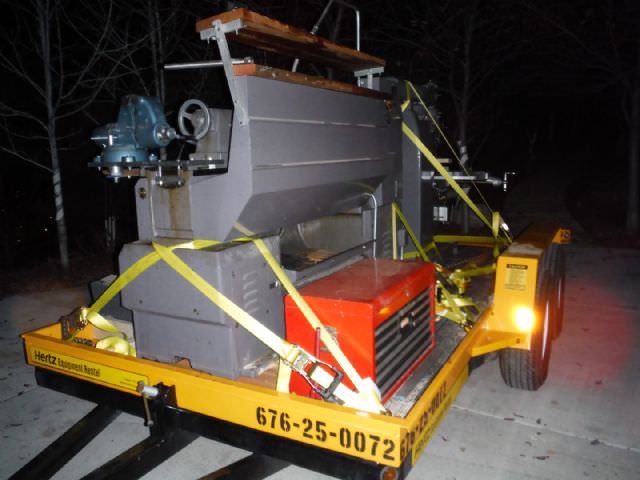

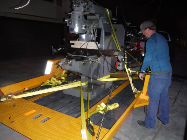

Denray Posted October 29, 2013 Author Report Share Posted October 29, 2013 8. And the rust shortens the life of the equipment. Thanks Robert. We just got back from a mad dash to UT and back to get some toys out of Dad's garage (house being sold) for my mechanical engineer son to have at his house. Poor kid. Click to Enlarge 47.52 KB Click to Enlarge 46.58 KB Quote Link to comment Share on other sites More sharing options...
