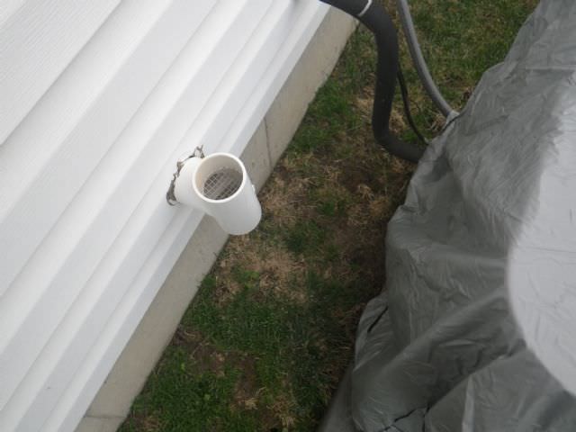

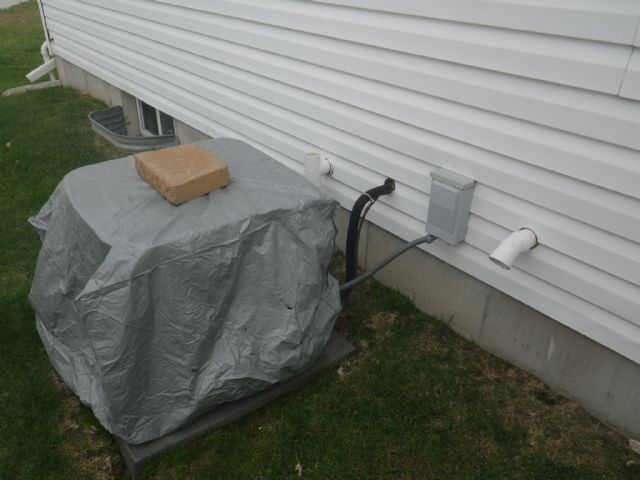

Mark P Posted November 5, 2013 Report Share Posted November 5, 2013 This exhaust pipe that is directly behind the ac (on left) is from a water heater. Does anyone know of a rule regarding this? Click to Enlarge 37.39 KB Click to Enlarge 42.3 KB Quote Link to comment Share on other sites More sharing options...

Marc Posted November 5, 2013 Report Share Posted November 5, 2013 Non-direct? OK. What's that other PVC pipe for? Marc Quote Link to comment Share on other sites More sharing options...
Bill Kibbel Posted November 5, 2013 Report Share Posted November 5, 2013 Non-direct? OK. What's that other PVC pipe for? Marc Water heater. Quote Link to comment Share on other sites More sharing options...

Mike Lamb Posted November 6, 2013 Report Share Posted November 6, 2013 Non-direct? OK. What's that other PVC pipe for? Marc I see two pipes terminations. I assume one pipe is for the water heater and the other is for the furnace. If both pipes are for one direct vent appliance they have been installed too far apart. Quote Link to comment Share on other sites More sharing options...
inspector57 Posted November 6, 2013 Report Share Posted November 6, 2013 I'm struggling to find a reason for it to cause a problem. I wouldn't write it up without one. Think about worst case scenario. The unit fails to ignite and dumps flammable fuel out the exhaust as it purges. Not something to dump onto an electrical appliance. Also aren't gas exhaust fumes slightly corrosive? Quote Link to comment Share on other sites More sharing options...
Mark P Posted November 6, 2013 Author Report Share Posted November 6, 2013 The one on the left is from a powered vent on a water heater. The one on the right is from a furnace. I was thinking there might be an issue with the corrosive nature of the exhaust causing damage to the ac fins; however, it is 10 years old and no signs of an issue. Quote Link to comment Share on other sites More sharing options...
