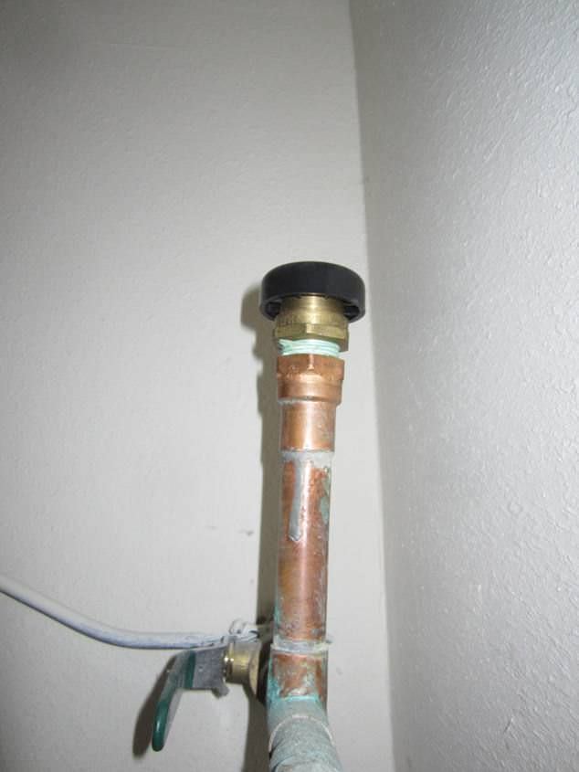

Mark Underwood Posted November 13, 2013 Report Share Posted November 13, 2013 This is installed on the cold water supply to the water heater where an expansion tank would normally be installed. The black cap just spins around, so I'm thinking it's an air gap or vent of some kind. I saw no label. Anyone know what it is? Mark Click to Enlarge 44.13 KB Quote Link to comment Share on other sites More sharing options...
rkenney Posted November 13, 2013 Report Share Posted November 13, 2013 Water hammer arrester. Quote Link to comment Share on other sites More sharing options...
Marc Posted November 13, 2013 Report Share Posted November 13, 2013 Water hammer arrester. That doesn't explain the device atop the pipe. I'll take a guess...air bleeder. Marc Quote Link to comment Share on other sites More sharing options...
Chad Fabry Posted November 13, 2013 Report Share Posted November 13, 2013 Good lord- you didn't really turn it, did you? Quote Link to comment Share on other sites More sharing options...
John Kogel Posted November 13, 2013 Report Share Posted November 13, 2013 It is a vacuum relief valve, boys. We are required to have them here. The theory is that if water pressure fails, that valve will prevent stinky tank water from siphoning out and entering the potable water supply. I am told this is never going to happen, but the plumbers are obliged to install them anyway. The plastic knob is just a cap. You can spin it all day if you feel so inclined. Chad is just jerkin your chain. [] BTW, it only sucks, whereas a pressure relief valve only blows. [] Quote Link to comment Share on other sites More sharing options...
Rob Amaral Posted November 13, 2013 Report Share Posted November 13, 2013 Can prevent a water heater storage tank from collapsing if Mr. Fire Truck starts sucking nearby on the public system... They are required here.. Vacuum-breaker Quote Link to comment Share on other sites More sharing options...

Douglas Hansen Posted November 17, 2013 Report Share Posted November 17, 2013 Our plumbing code (UPC section 608.7) requires them whenever a water heater is elevated above the level of the fixtures. An example would be a commercial building with a small water heater above the ceiling of the restroom baths. We don't often find attic water heaters in houses, though if we do, they are supposed to have these vacuum relief valves. Here is what Watts says: "Series N36 Water Service Vacuum Relief Valves are used in water heater/tank applications to automatically allow air to enter into the piping system to prevent vacuum conditions that could siphon the water from the system and damage water heater/tank equipment." It still doesn't make sense to me. Quote Link to comment Share on other sites More sharing options...
Marc Posted November 17, 2013 Report Share Posted November 17, 2013 Makes sense to me. Under zero pressure conditions, the valve allows air to enter the cold water inlet at the top of the water heater and relieve any vacuum that might develop. Without a vacuum, siphoning via the street main can't drain it unless a cross connection of some sort exists. Marc Quote Link to comment Share on other sites More sharing options...
