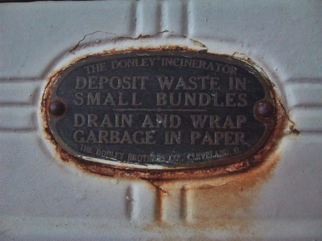

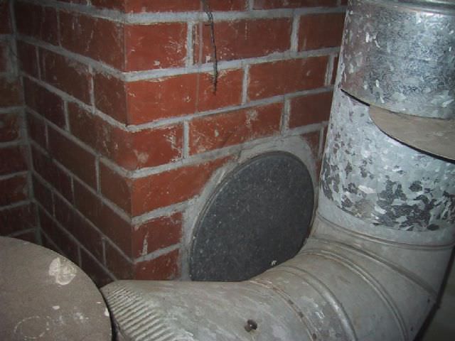

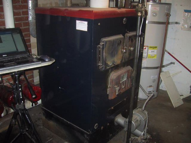

Jim Katen Posted November 16, 2013 Report Share Posted November 16, 2013 The apartment building, as far as I can tell, was built in 1940. The cast iron US Radiator "Capitol Red Top" hydronic boiler is identified as "Size B07" and "Serial 59443." It was clearly an oil-fired boiler until 1986, when it was converted to gas. It's working fine today. I'm wondering how old it is. I would have simply assumed that it's original to the building, but one thing suggests that it's not. In the boiler room, the chimney has a very large opening that's been sealed. I suspect that this opening was to accommodate a previous boiler with a larger smoke pipe. The opening is to low to have ever worked with this boiler. The boilder also seems to be a bit svelt for 1940. Any ideas? Click to Enlarge 42.64 KB Click to Enlarge 52.18 KB Quote Link to comment Share on other sites More sharing options...
kurt Posted November 16, 2013 Report Share Posted November 16, 2013 Original. Coal fired, converted to oil, then gas. Smoke pipe changed during oil conversion...(?). Quote Link to comment Share on other sites More sharing options...
Rob Amaral Posted November 16, 2013 Report Share Posted November 16, 2013 We see those a lot... they'd put the barometric damper in the chimney like that, instead of as part of the vent.. just saw one yesterday.. Quote Link to comment Share on other sites More sharing options...
Jim Katen Posted November 16, 2013 Author Report Share Posted November 16, 2013 I doubt that it was ever coal, not in this area in 1940. The top of the large patched hole in the chimney is about two inches lower than the top of the outlet in the back of the boiler. I can't imagine that they ran the smoke pipe downhill. Or are you suggesting that the large hole was where the barometric damper was located? I've never seen a setup like that before - even the most ancient installations that I've seen always had the damper on the pipe. I can see how it might work, though. Quote Link to comment Share on other sites More sharing options...

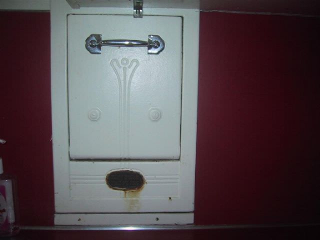

Bill Kibbel Posted November 16, 2013 Report Share Posted November 16, 2013 That brand of boiler can't be later than 1954. I've inspected many old apt. buildings and more often than not, there's evidence of a trash incinerator that vented into the same flue as the boiler. The other possible reason for the lower capped opening is for a clean-out. Quote Link to comment Share on other sites More sharing options...
Jim Katen Posted November 16, 2013 Author Report Share Posted November 16, 2013 That brand of boiler can't be later than 1954. I've inspected many old apt. buildings and more often than not, there's evidence of a trash incinerator that vented into the same flue as the boiler. The other possible reason for the lower capped opening is for a clean-out. The building did once have an incinerator. Perhaps that was it. The cleanout was on the other side of the chimney. I'm also suspecting that the boiler might have been raised a few inches to keep it away from water on the floor. Quote Link to comment Share on other sites More sharing options...
Bill Kibbel Posted November 16, 2013 Report Share Posted November 16, 2013 We see those a lot... they'd put the barometric damper in the chimney like that, instead of as part of the vent.. just saw one yesterday.. Yeah, but aren't they always installed above where the vent connectors connect to the chimneys and not below? Quote Link to comment Share on other sites More sharing options...
Jim Katen Posted November 17, 2013 Author Report Share Posted November 17, 2013 From the incinerator: Click to Enlarge 23.39 KB Click to Enlarge 47.84 KB Every time I see one of these things I'm reminded of their gruesome association with the character of Luca Brasi from the Godfather. The scene wasn't depicted in the movie and I won't recount it here. Google it if you want to be depressed. Quote Link to comment Share on other sites More sharing options...
Rob Amaral Posted November 17, 2013 Report Share Posted November 17, 2013 Download Attachment: IMG_5520.JPG 113.3 KB You can barely see it in this shot (taken 2 days ago).. Oil-fired 'conversion' boiler (formerly coal) (at L) behind water heater. Vent goes into chimney. Barometric damper is 'in' the chimney at the circle... we see this a lot, but less and less as these old monsters get swapped-out.. "Strange, but true" Quote Link to comment Share on other sites More sharing options...
ghentjr Posted November 17, 2013 Report Share Posted November 17, 2013 US Radiator published a Red Top C series booklet in 1934. Would reason stand that the B was before the C? Quote Link to comment Share on other sites More sharing options...
Jim Katen Posted November 17, 2013 Author Report Share Posted November 17, 2013 Download Attachment: IMG_5520.JPG 113.3?KB You can barely see it in this shot (taken 2 days ago).. Oil-fired 'conversion' boiler (formerly coal) (at L) behind water heater. Vent goes into chimney. Barometric damper is 'in' the chimney at the circle... we see this a lot, but less and less as these old monsters get swapped-out.. "Strange, but true" Thanks, I'll keep an eye out for similar installations in the future. Quote Link to comment Share on other sites More sharing options...
Jim Katen Posted November 17, 2013 Author Report Share Posted November 17, 2013 US Radiator published a Red Top C series booklet in 1934. Would reason stand that the B was before the C? Could be. No one seems to really know when the building was built. I'm basing my estimate on the manufacturing date stamped on the inside of the "house" disconnect panel. It's possible that the panel was added later. On the other hand, US Radiator had series A, B, and C Red Tops. The letters might have referred to classifications rather than the sequence of manufacture. Quote Link to comment Share on other sites More sharing options...

mjr6550 Posted November 19, 2013 Report Share Posted November 19, 2013 The link below is a catalog with that boiler. The catalog is from 1934. Of course, old boilers were manufactured for many years with few changes. https://ia601202.us.archive.org/17/item ... iators.pdf Quote Link to comment Share on other sites More sharing options...

Jim Katen Posted November 19, 2013 Author Report Share Posted November 19, 2013 The link below is a catalog with that boiler. The catalog is from 1934. Of course, old boilers were manufactured for many years with few changes. https://ia601202.us.archive.org/17/item ... iators.pdf Thanks, Mark, that's fabulous. Quote Link to comment Share on other sites More sharing options...
