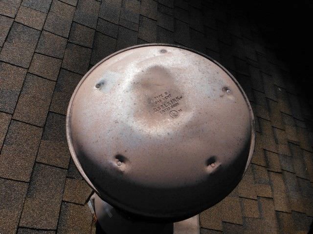

Denray Posted November 22, 2013 Report Share Posted November 22, 2013 Is it OK for the cap to be a B vent? Click to Enlarge 62.33 KB Quote Link to comment Share on other sites More sharing options...
mjr6550 Posted November 23, 2013 Report Share Posted November 23, 2013 No. B-vent is only rated for gas. I assume the cap is aluminum, which is used for b-vents. L-vents are used for oil. L-vents are stainless steel. I think the aluminum would corrode. I don't know how long it would take to corrode. Quote Link to comment Share on other sites More sharing options...
