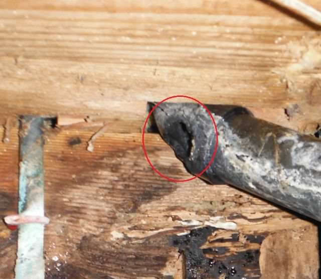

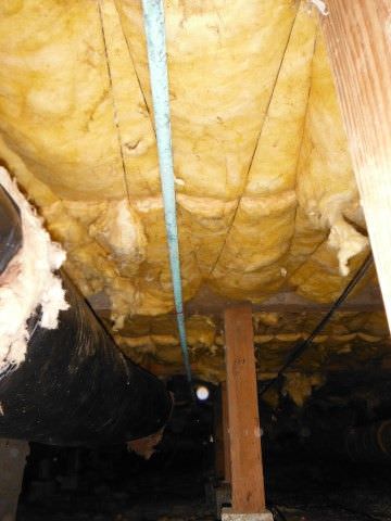

Denray Posted November 22, 2013 Report Share Posted November 22, 2013 This was green for 30 ft. Another pipe parallel to it was black for 20 ft. Click to Enlarge 32.3 KB Quote Link to comment Share on other sites More sharing options...
John Kogel Posted November 23, 2013 Report Share Posted November 23, 2013 I'll bet the green one is sweating harder than the black one. I'll bet the black one is a hot line. i'll bet it's a damp crawl too. [] Quote Link to comment Share on other sites More sharing options...
Denray Posted November 23, 2013 Author Report Share Posted November 23, 2013 Not damp yet. Just never saw a run that long of the green stuff. What is the green stuff or black stuff anyway? Quote Link to comment Share on other sites More sharing options...
John Kogel Posted November 23, 2013 Report Share Posted November 23, 2013 Copper oxide if I had to guess, which I do. But why corrosion, I can't say. Maybe some corrosive materials stored under the house. Quote Link to comment Share on other sites More sharing options...
Jim Katen Posted November 23, 2013 Report Share Posted November 23, 2013 Past break in a drainpipe? Sewer gas = discolored copper. Quote Link to comment Share on other sites More sharing options...
Denray Posted November 23, 2013 Author Report Share Posted November 23, 2013 They're on septic. Quote Link to comment Share on other sites More sharing options...
Tom Raymond Posted November 23, 2013 Report Share Posted November 23, 2013 So it's their own gas and not the neighborhood's. Quote Link to comment Share on other sites More sharing options...
Jim Katen Posted November 23, 2013 Report Share Posted November 23, 2013 They're on septic. No dif. Quote Link to comment Share on other sites More sharing options...
Denray Posted November 23, 2013 Author Report Share Posted November 23, 2013 Jim, do you ever get tired of knowing everything? Click to Enlarge 62.54 KB We're sure glad you don't. Quote Link to comment Share on other sites More sharing options...
