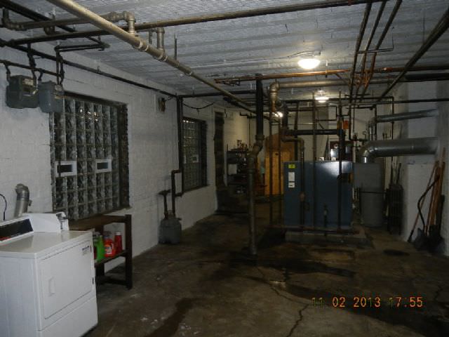

kurt Posted December 5, 2013 Report Share Posted December 5, 2013 A couple months, glass block, a lot of white paint, makes for a different boiler room. I installed an RD 1400 microprocessor control system, been fiddling with the vents, and I'm discovering the miracle of steam heat. I know a few guys that wax all crazy about how incredibly efficient it is, they don't know why it went out of style, and how delightfully warm and cozy it makes an apartment. Well, I'm now one of those guys. I'm heating a 5 unit, (approx.) 6600+sf 1929 apartment building for less money than I spend to heat my bungalow, and I keep the apartments @ 72.5degF, and my bungalow is kept @ 65 to keep it from being too expensive. For the apartments that had cool or cold radiators, I've been fiddling with orifice sizing, and I got it so every radiator in the place heats quickly, evenly, and wonderfully. When you get it right, it's like magic. The control kicks on the boiler, it fires for about 7 minutes, there's a "sigh" from all the vents on the condensate returns for about 5 seconds, then there's what I call "the flash". Suddenly, in the space of a few seconds, all those 20 & 30 pound iron fittings on the boiler go from being room temp to too hot to touch, and in an instant every radiator is warm and toasty. In an instant. With no pressure; the gauge never bumps off 0. OK, maybe it's .01 psi, but the gauge doesn't move. (yes, it works, I installed a new one.) It's freaky. In an instant. My building is solid masonry, 14" thick walls, cast concrete coffered 1st fl. platforms with structural terra cotta infill, 2nd fl. platforms are wood frame, wood lath plaster, double hung single panes, storm windows, and not a speck of insulation anywhere. Nothing. It's the poster child for what should be a completely inefficient costly mess of a masonry building. And it heats in cold Chicago weather for surprisingly less than <$300 a month, while maintaining >72degF average temps in all apartments. How? Why? This isn't supposed to work this way. But it does. I can't figure it out. Is there some magic thermodynamic principle I'm missing? Click to Enlarge 57.36 KB Click to Enlarge 51.98 KB Quote Link to comment Share on other sites More sharing options...

Jim Katen Posted December 5, 2013 Report Share Posted December 5, 2013 . . . How? Why? This isn't supposed to work this way. But it does. I can't figure it out. Is there some magic thermodynamic principle I'm missing? . . . It's probably, at least in part, due to the magic of radiant heat. A hot object in a room makes people feel comfortable. Quote Link to comment Share on other sites More sharing options...
kurt Posted December 5, 2013 Author Report Share Posted December 5, 2013 Radiant's got to be part of it. The building is a lot of tonnage in steel and masonry. Pipes snake everywhere, they gotta heat up all that mass, and it all goes radiant. But why so cheap to operate? Quote Link to comment Share on other sites More sharing options...
Rob Amaral Posted December 5, 2013 Report Share Posted December 5, 2013 I think if you 100% insulate those steam supply lines with tubular jacketed fiberglass steam pipe insulation you'd get even more out of that system.. Quote Link to comment Share on other sites More sharing options...
Tom Raymond Posted December 5, 2013 Report Share Posted December 5, 2013 The only reason to insulate those pipes is to lower the boiler room temps. Quote Link to comment Share on other sites More sharing options...
Neal Lewis Posted December 5, 2013 Report Share Posted December 5, 2013 The only reason to insulate those pipes is to lower the boiler room temps. Then why were the steam pipes well insulated with asbestos to begin with, if it doesn't help much? Quote Link to comment Share on other sites More sharing options...
Mike Lamb Posted December 5, 2013 Report Share Posted December 5, 2013 Maybe the 1st floor helps serve as a secondary massive concrete and terra cotta radiator generating additional warmth upward. Uninsulated boiler pipe makes for a nice toasty basement. Quote Link to comment Share on other sites More sharing options...
Bill Kibbel Posted December 5, 2013 Report Share Posted December 5, 2013 The only reason to insulate those pipes is to lower the boiler room temps. or to have more steam condense in the radiators rather than in the pipes before reaching the radiators. I think that's the intent behind the design of steam heating systems. Kurt, it might be Karma. You pleased your tenants (rare for landlords) and low heating costs is your reward. Or, maybe the utility just read the meter wrong. [:-bigeyes Quote Link to comment Share on other sites More sharing options...
kurt Posted December 5, 2013 Author Report Share Posted December 5, 2013 I think Lamb has something close to it. The boiler room is nice and toasty, and the entire 1st fl. platform is like a big radiant heat sink. After that, I have no idea. Yes, I always thought insulation was intended to keep the condensing happening in the radiators and not in the long lateral runs. But this one doesn't have any insulation...never did, and the radiators all heat up at the same time, and there's not a single clank, ting, ping, or rattle. Ever. It just gets hot. Quietly. Which I've never experienced before with any steam system. There's almost always a little ping or ghost rattle in every other system I've operated. Quote Link to comment Share on other sites More sharing options...

Rob Amaral Posted December 6, 2013 Report Share Posted December 6, 2013 They are indeed "friendly" systems to be near in a big boiler room like that.. cozy suckers.. Quote Link to comment Share on other sites More sharing options...
