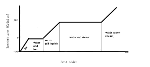

hoosier inspector Posted December 9, 2013 Report Share Posted December 9, 2013 The condensation of steam to water on the inside surface of the radiator moves massive amounts of heat, much more than conduction. If you size the vent properly it will utilize all the radiator surface with no waste. That's what I'm trying to grasp. I can read the formula, but have no intuitive sense of what it means. Moving heat around as steam.....what's it mean? Thermodynamics is not my strong suit. Hot water boilers work on the principle of moving sensible heat. 1. Heat a material. 2. Move the material to the space calling for heat. 3. Let the material radiate the heat into the space. 4. Return the material and repeat. Steam boilers work on the principle of moving latent heat. 1. Add enough heat to water to change it's state into vapor. 2. Allow the vapor to condense onto a surface which releases all the latent heat of evaporation. 3. Return the water back to re-heat. Click to Enlarge 6.26 KB If you notice the 2 horizontal sections in the chart, these are the phase changes that suck up heat without raising the temperature. It takes 180 btu to raise 1# of water (about 1 pint) from 32degF to 212degF (freezing to boiling) but 970 btu (over 5 times as much) to change 1# of water to 1# of steam. Note the steam is still at 212 degrees, just in another state. All this heat is latent heat. It's the heat you get out of condensing steam, the heat recovered from flue gas in a high efficiency furnace, the heat removed from a condensing coil in an A/C unit. This is only a way to move heat around.This has nothing to do with efficiency of producing heat from fuel, and containing it in a structure. Quote Link to comment Share on other sites More sharing options...
