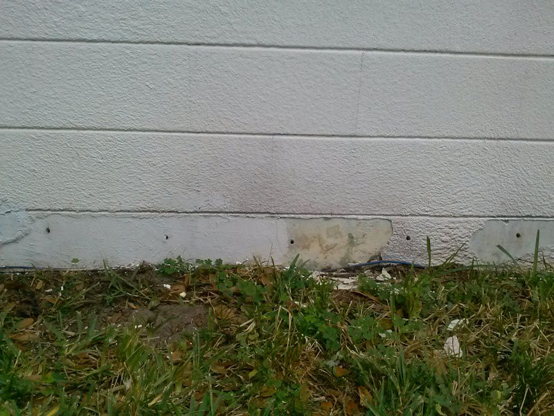

omagic12 Posted December 12, 2013 Report Share Posted December 12, 2013 1958 CB home in west central Florida. My home has 3/8" (approx.) holes every 12" apart and 3" above the ground similar to this: http://homeguides.sfgate.com/drill-weep ... 26419.html . Some have been filled in (prior owner?), but most are now revealed due to the stucco (sparkle-crete) coming off on several spots where the ground meets the walls. I am starting to feather in some spray-deck grout on those spots and would like to know if I can cover those holes? Also, out of curiosity, during initial construction they used a green colored water proofing barrier between the CB and stucco. What is that stuff? It looks to be in very good condition whatever it is. They used it from the bottom of the slab to the top of the walls. Quote Link to comment Share on other sites More sharing options...

omagic12 Posted December 12, 2013 Author Report Share Posted December 12, 2013 Posted a few pics. Hopefully they'll help. The first pic shows the grout/stucco feathered in. Pics also show the green sealer I inquired about. Download Attachment: Weep holes and grout.jpg 241.34 KB Download Attachment: Weep Holes 3.jpg 233.37 KB Quote Link to comment Share on other sites More sharing options...
Charles Posted December 12, 2013 Report Share Posted December 12, 2013 Sure looks like subterranean termite treatment holes. Where is your finished floor in relationship to the holes? Charles Quote Link to comment Share on other sites More sharing options...
omagic12 Posted December 13, 2013 Author Report Share Posted December 13, 2013 Finished floor is roughly level with those holes. It just occurred to me that the holes around the perimeter may have caused the deterioration of the stucco (sparkle-crete), as it's only at that level (ground meets wall) where the stucco has come off. So, can I cover the holes with new grout/stucco? I plan to continue tomorrow. Quote Link to comment Share on other sites More sharing options...
omagic12 Posted December 13, 2013 Author Report Share Posted December 13, 2013 At this point I am 99% sure they are from a termite treatment, as the kind replies here have mentioned. Further internet searching points in that direction as well. I will stucco over them. Thanks for all the replies. Quote Link to comment Share on other sites More sharing options...
rdhutch Posted December 13, 2013 Report Share Posted December 13, 2013 I recommend you plug the holes with type N mortar. Mix small amounts to the consistency of peanut butter. Roll a plug slightly larger than the diameter of the hole and apprx 3/4" long. Insert your plug into the hole and smooth the exterior edges. Do this prior to applying new stucco. If the hole is not plugged the new stucco over the holes will crack and collapse. As a side note, these holes should be located just below the bottom of the slab. If they are at ground level, well below the slab, then the termite treatment was done incorrectly. If they are above the slab, again the treatment was done incorrectly. If the holes were drilled through the stucco and not plugged, this could have contributed to the current condition. Quote Link to comment Share on other sites More sharing options...
