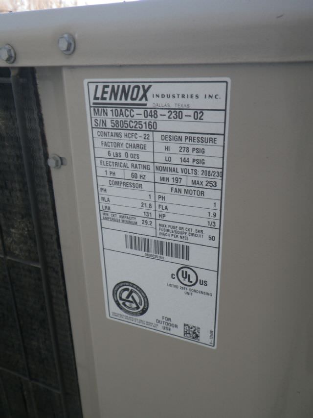

Mark P Posted January 6, 2014 Report Share Posted January 6, 2014 Click to Enlarge 52.96 KB Quote Link to comment Share on other sites More sharing options...
Chad Fabry Posted January 6, 2014 Report Share Posted January 6, 2014 4 ton. 2.5 Ton would be a 30 Quote Link to comment Share on other sites More sharing options...
Marc Posted January 6, 2014 Report Share Posted January 6, 2014 My chart says 4 tons, built in March 05'. Marc Quote Link to comment Share on other sites More sharing options...
Mark P Posted January 6, 2014 Author Report Share Posted January 6, 2014 Thanks I asked because both "30" and "48" are in the model number. Quote Link to comment Share on other sites More sharing options...
Marc Posted January 6, 2014 Report Share Posted January 6, 2014 That 30 is actually 230, the voltage. Marc Quote Link to comment Share on other sites More sharing options...
Neal Lewis Posted January 6, 2014 Report Share Posted January 6, 2014 A 2 1/2 ton unit wouldn't have a 50 amp max breaker. Quote Link to comment Share on other sites More sharing options...
Garet Posted January 7, 2014 Report Share Posted January 7, 2014 Hint: for many (most?) models you'll find a "0" before the numbers that indicate tonnage. Quote Link to comment Share on other sites More sharing options...
rjbrown2 Posted January 7, 2014 Report Share Posted January 7, 2014 Maybe this is Captain Obvious stuff...048 is 4 tons as short hand for 48,000 BTU/hr or 024 for two tons = 24,000 BTU/hr etc. Quote Link to comment Share on other sites More sharing options...
