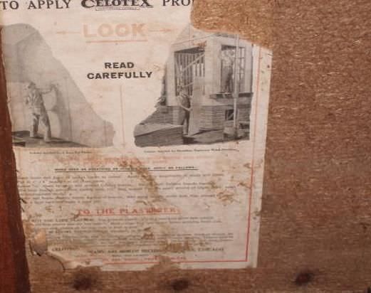

Bill Kibbel Posted February 1, 2014 Report Share Posted February 1, 2014 I found Celotex (fiberboard made from bagasse - the waste pulp from sugercane processing) used for backing of the plaster walls in a large home built in 1922. Here's a picture of a label, but this is from a later building. Click to Enlarge 37.71 KB Quote Link to comment Share on other sites More sharing options...
John Kogel Posted February 1, 2014 Report Share Posted February 1, 2014 Thanks. I had no idea they were turning out 4 foot sheets in that era. Quote Link to comment Share on other sites More sharing options...
