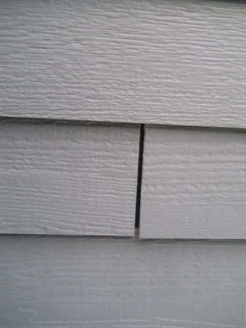

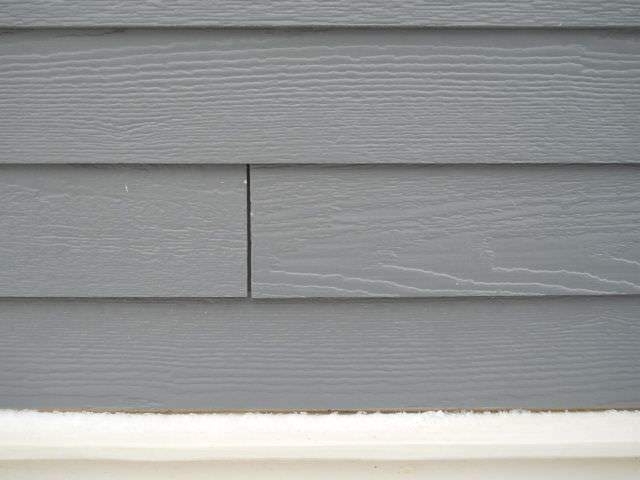

Mike Lamb Posted February 2, 2014 Author Report Share Posted February 2, 2014 This particular job had flashing behind all the butt joints. That's a good thing. But the instructions say there should be no gaps at the butt joints. This job had some 1/4" gaps at the butt joints. From Cert. Butt end/joints should be installed with factory-sealed or factory-prefinished ends butted together in moderate contact. And then in bold: NOTE: It is never acceptable to leave a gap of any size at a butt end/joint. Click to Enlarge 37.72 KB Click to Enlarge 40.09 KB I don't see 1/4" gaps as a problem but again, the instructions seem adamant. Bolds seem adamant. And then they get all spongy that they don't really mean what they say unless something bad happens. If the manufacturer can't commit to how their product should be installed it makes it harder on the HI. I have to make the same doofus fudging they do. Quote Link to comment Share on other sites More sharing options...
