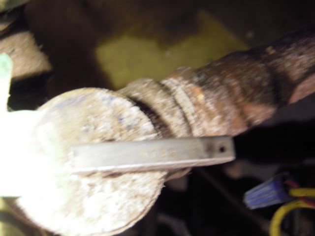

Mark P Posted February 5, 2014 Report Share Posted February 5, 2014 Can the age of a Weil-McLean boiler be found in this serial # CR 1294583. I'm 50/50 between 1994 or 1983. Click to Enlarge 55.62 KB Quote Link to comment Share on other sites More sharing options...
Neal Lewis Posted February 5, 2014 Report Share Posted February 5, 2014 I'm not sure about the serial number. But, judging by the age of the expansion tank and a filltrol type fill valve and the lack of a backflow preventer, I would go with 1983. Did you get a look at the gas valve? Quote Link to comment Share on other sites More sharing options...
Bill Kibbel Posted February 5, 2014 Report Share Posted February 5, 2014 It should be a CP number that you can look up here: http://www.weil-mclain.com/en/weil-mcla ... cp-lookup/ Quote Link to comment Share on other sites More sharing options...
Mark P Posted February 5, 2014 Author Report Share Posted February 5, 2014 Oh CP number! It turns out to be 1986. That is a very usefull website. Thank you Mr. Bill Quote Link to comment Share on other sites More sharing options...

Tom Raymond Posted February 6, 2014 Report Share Posted February 6, 2014 Does someone have a picture of the dates on a gas valve or TPR? I have yet to find them. I even just went and looked at my boiler and water heater. No dates. Quote Link to comment Share on other sites More sharing options...
mjr6550 Posted February 7, 2014 Report Share Posted February 7, 2014 Does someone have a picture of the dates on a gas valve or TPR? I have yet to find them. I even just went and looked at my boiler and water heater. No dates. Here are a few examples. The label on the boiler water feed valve looks the same at the PRV. On Conbraco PRVs the year is usually stamped into the round metal label on the top of the valve. Click to Enlarge 30.78 KB Click to Enlarge 28.32 KB Click to Enlarge 84.69 KB Quote Link to comment Share on other sites More sharing options...
