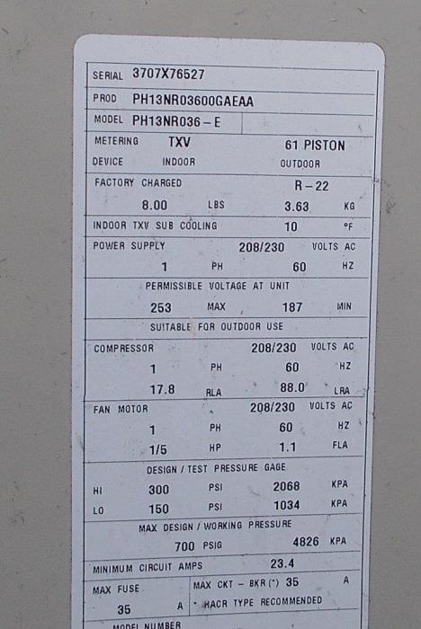

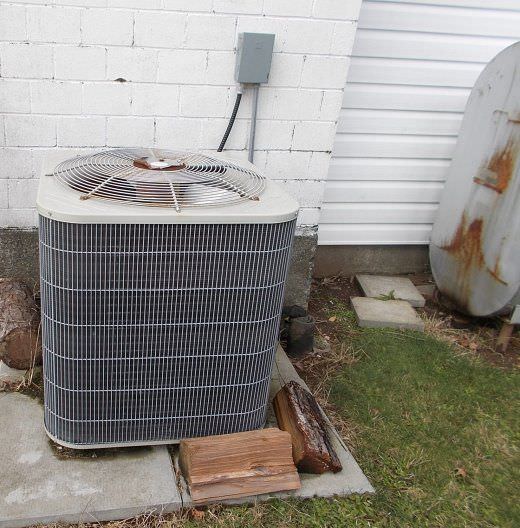

John Kogel Posted February 13, 2014 Author Report Share Posted February 13, 2014 Thanks. Sam, the Payne heat pump today has a tall compressor and says 'piston' on the label. I guess for every rule, there is an exception to the rule, eh? [] Actually, I don't think it has a piston, just says it does. Click to Enlarge 29.04 KB Click to Enlarge 58.83 KB Yeah, that oil tank's sprung a bit of a leak. Click to Enlarge 69.56 KB Quote Link to comment Share on other sites More sharing options...

Samuel Rock Posted February 13, 2014 Report Share Posted February 13, 2014 Thanks. Sam, the Payne heat pump today has a tall compressor and says 'piston' on the label. I guess for every rule, there is an exception to the rule, eh? [] Actually, I don't think it has a piston, just says it does. Click to Enlarge 29.04 KB Click to Enlarge 58.83 KB Yeah, that oil tank's sprung a bit of a leak. Click to Enlarge 69.56 KB That compressor is a scroll, If you had looked at the first letter of the model number on the compressor it would have been a "Z" Look at you photo of the outdoor unit information tag, Do you see where it says metering device? That is telling you it has a TXV on the indoor coil and and a #61 piston on the outdoor coil Click to Enlarge 8.44 KB Click to Enlarge 8.32 KB Sam Quote Link to comment Share on other sites More sharing options...
