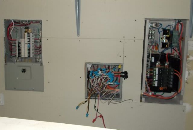

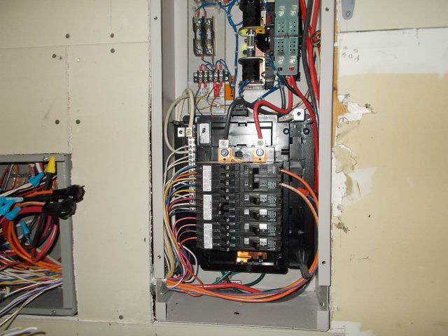

John Kogel Posted February 13, 2014 Report Share Posted February 13, 2014 I had my hands full with this place about a month ago, and wish I had spent more time getting specs. But this is typical for here, the essential circuits are in the generator panel, which serves as a subpanel when there's no emergency. The emergency here was the somebody let Billy Bob handle some tools. [] Click to Enlarge 29.53 KB Click to Enlarge 59.44 KB Click to Enlarge 42.32 KB Quote Link to comment Share on other sites More sharing options...
Marc Posted February 13, 2014 Report Share Posted February 13, 2014 I was trying to avoid the epic long story and just say that the install was not to code and give the code that it did not meet. But maybe you will get a better picture of what I am trying to paint here. Every generator that is installed in St. Mary parish is installed in non compliance to NEC 702.5. I have been fighting this for 5 years now. Marc Call your local city inspection office and ask them for the generator installation permit package. The installer must do a load calculation per NEC 220 and if a 200A-SE ATS is installed and the generator does not carry the full load of the house then Load Shedding must be installed or the job will fail. Sam St. Mary Parish has a code authority but I've seen firsthand how contractors bypass enforcement by bribing a third party code inspector and screwing the home owner or buyer. Louisiana is lax in pushing the Parishes, especially the coastal Parishes, to properly enforce the codes, mostly for political reasons. Lafayette is no exception. We home inspectors have no bite. Marc Quote Link to comment Share on other sites More sharing options...

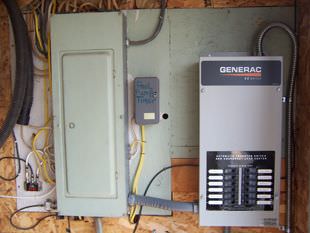

Samuel Rock Posted February 13, 2014 Author Report Share Posted February 13, 2014 This is how 99% of ATS get wired. this is cut from the generac manual. At this point you are switching every load in the house! Click to Enlarge 90.62 KB Sam Quote Link to comment Share on other sites More sharing options...
