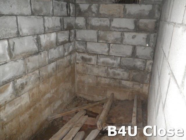

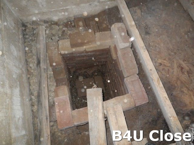

Erby Posted March 15, 2014 Report Share Posted March 15, 2014 Any ideas of what this would be. Back in the crawl space under the corner of a 40 or 50 year old addition on a 70 or 80 year old house? Click to Enlarge 51.6 KB Click to Enlarge 58.96 KB Quote Link to comment Share on other sites More sharing options...
ghentjr Posted March 15, 2014 Report Share Posted March 15, 2014 Old sump pit. The pump rested on the three bricks at the bottom. Quote Link to comment Share on other sites More sharing options...
mjr6550 Posted March 16, 2014 Report Share Posted March 16, 2014 Any ideas of what this would be. Back in the crawl space under the corner of a 40 or 50 year old addition on a 70 or 80 year old house? Click to Enlarge 51.6 KB Click to Enlarge 58.96 KB Looks like an old well pit. Old ones often had a jet pump in the pit. Quote Link to comment Share on other sites More sharing options...
