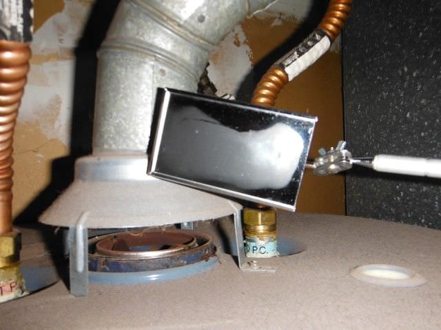

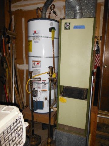

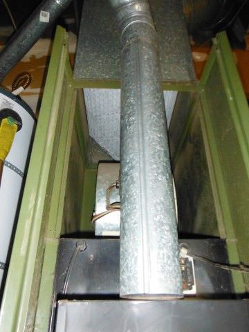

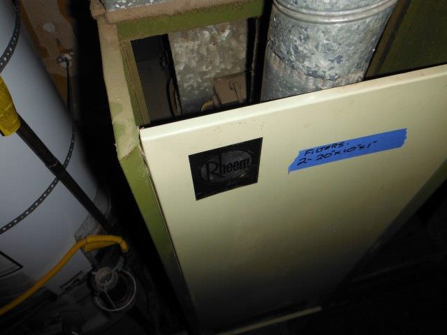

Denray Posted March 29, 2014 Report Share Posted March 29, 2014 Without the furnace running the nearby WH has poor draft. Click to Enlarge 52.14 KB The furnace, right next to it, is missing the panel that seals off the air filter compartment. Click to Enlarge 33.61 KB Click to Enlarge 37.79 KB Must be pulling big time on that WH when the furnace is running. Click to Enlarge 36.38 KB Other than that, and being a bit old, I didn't see a problem. Quote Link to comment Share on other sites More sharing options...
Jim Katen Posted March 29, 2014 Report Share Posted March 29, 2014 I haven't seen one of those old green Rheems in a long time. But, as I recall, they always had easy-to-find cracks in the heat exchangers. Quote Link to comment Share on other sites More sharing options...
