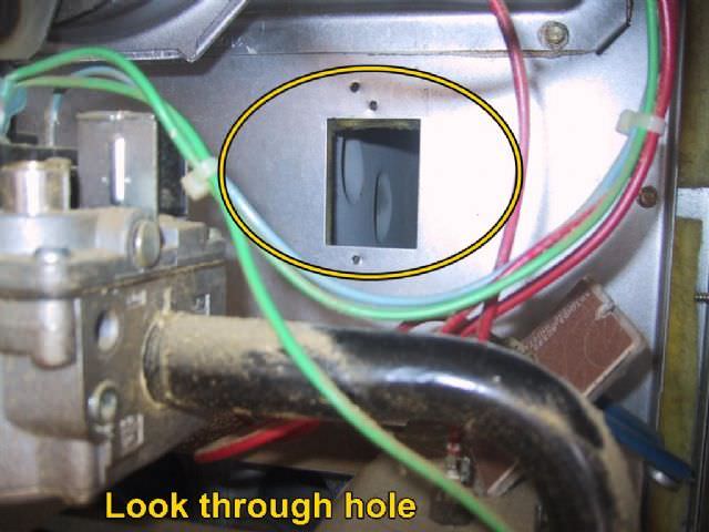

Robert Jones Posted May 3, 2014 Report Share Posted May 3, 2014 Had an inspection today, on the furnace, was a label that indicated service recently. As a part of the service description, the technician made a comment that there was a "dimple" crack in the exchanger behind the high temp limit. Can't say that I have ever heard that terminology before. I know what I typically say when there is a crack in the exchanger. Is "dimple" not a replaceable offense? Quote Link to comment Share on other sites More sharing options...
Jim Katen Posted May 4, 2014 Report Share Posted May 4, 2014 Had an inspection today, on the furnace, was a label that indicated service recently. As a part of the service description, the technician made a comment that there was a "dimple" crack in the exchanger behind the high temp limit. Can't say that I have ever heard that terminology before. I know what I typically say when there is a crack in the exchanger. Is "dimple" not a replaceable offense? He's talking about the near ubiquitous cracking around the dimples in the Carrier line (Bryant, Payne, Day & Night) of furnaces. It's a crack in the heat exchanger and the heat exchanger or the entire furnace should be replaced. Quote Link to comment Share on other sites More sharing options...
Jim Katen Posted May 4, 2014 Report Share Posted May 4, 2014 Here's the inspection sequence, if you're interested in discovering these cracks during an inspection. Click to Enlarge 57.17 KB Click to Enlarge 54.25 KB Click to Enlarge 20.85 KB Do not neglect to turn off the power before doing this. If you don't and you ground out the high limit switch, you'll blow a fuse that will prevent the furnace from working. Then you have to go out to your car and swipe a fuse from it to get the furnace working again. Quote Link to comment Share on other sites More sharing options...
Robert Jones Posted May 4, 2014 Author Report Share Posted May 4, 2014 As always, thanks Jim. It was a Carrier, located in a crawl space. Wonder why the tech wouldn't call it for repair/replacement. I will in my report. Quote Link to comment Share on other sites More sharing options...
