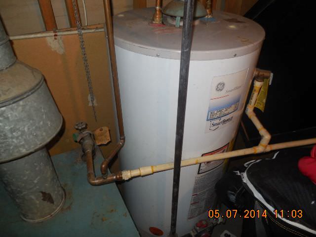

Charlie R Posted May 8, 2014 Report Share Posted May 8, 2014 At yesterdays inspection, I found where the pressure relief valve for the 1959 Burnham boiler was combined with the TPR valve discharge tube of the water heater, and what I believe is a copper condensate drain line from the attic A/C airhandler, all into the laundry tub. The main trunk of these combined discharges is CPVC piping. Now I know the discharges are not supposed to go into the laundry tub, but what about the combining of them and the use of CPVC? Click to Enlarge 38.45 KB Quote Link to comment Share on other sites More sharing options...
Scottpat Posted May 8, 2014 Report Share Posted May 8, 2014 CPVC is fine... Aren't TPR lines suppose to discharge to a visible location and shouldn't be tied in with any other type of discharge lines. That is also a DIY GE water heater so you know it came from Home Depot or Lowes. Quote Link to comment Share on other sites More sharing options...
Charlie R Posted May 8, 2014 Author Report Share Posted May 8, 2014 Thanks Scott. You are correct, the big question to me is the combining of all these drains into one discharge tube. I have read the IBC section on discharge tubes and it describes the size, the discharge point, the lack of threads on the discharge end, etc, but doesn't address if these have to be run separately or can be combined. If it is OK to combine them, shouldn't they have to go to a larger diameter? Quote Link to comment Share on other sites More sharing options...
Marc Posted May 8, 2014 Report Share Posted May 8, 2014 P2803.6.1 Requirements for discharge pipe.The discharge piping serving a pressure-relief valve, temperature-relief valve or combination valve shall; ... 4. Serve a single relief device and shall not connect to piping serving any other relief device or equipment. ... Marc Quote Link to comment Share on other sites More sharing options...
Charlie R Posted May 8, 2014 Author Report Share Posted May 8, 2014 There it is! Thanks Marc, much appreciated. Charlie Quote Link to comment Share on other sites More sharing options...
