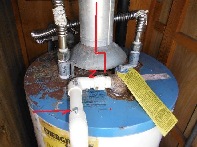

Denray Posted May 16, 2014 Report Share Posted May 16, 2014 And the cpvc is a bit close to the vent. Even worse if the vent were centered. Click to Enlarge 60.22 KB Quote Link to comment Share on other sites More sharing options...
Jim Baird Posted May 17, 2014 Report Share Posted May 17, 2014 Never seen a PT relief that close to the center of the top...btw it is pvc not cpvc, verdad? I bet they used the thicker pipe to resist the heat? Copper would obviously be better. Quote Link to comment Share on other sites More sharing options...
