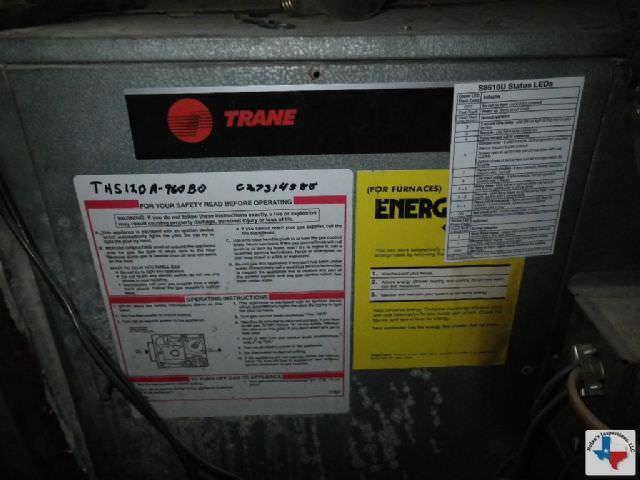

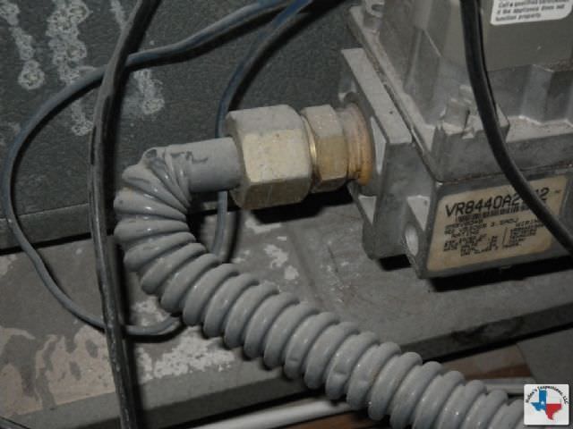

Nolan Kienitz Posted May 21, 2014 Report Share Posted May 21, 2014 Property inspected yesterday (Dallas, TX), built in 1967. Furnace in attic (typical for Texas), but does not have any dataplate left on system. There were some handwritten numbers on a sticker at the side of the system and there was a label on the manifold. I tried to correlate the handwritten numbers to the HVAC age sources I have, but came up empty. Anyone have any clues at possible age of system? EVAP coil (2007 - American Standard) was connected to a 60,000 BTU (5 ton) condenser (2006 - Trane). Flamebed was easily 90% yellow and of a style that I happen to call a 'flatbed' spread out across the bottom of the furnace. Small viewing source adjacent to access panel. Thanks in advance. Click to Enlarge 47.82 KB Click to Enlarge 46.92 KB Click to Enlarge 17.3 KB Quote Link to comment Share on other sites More sharing options...
Nolan Kienitz Posted May 21, 2014 Author Report Share Posted May 21, 2014 My local HVAC sources were able to get back with me this AM with the information. DOB: 1988 BTU: 120,000 And a caution to NOT USE the system with that much yellow flame. Quote Link to comment Share on other sites More sharing options...
