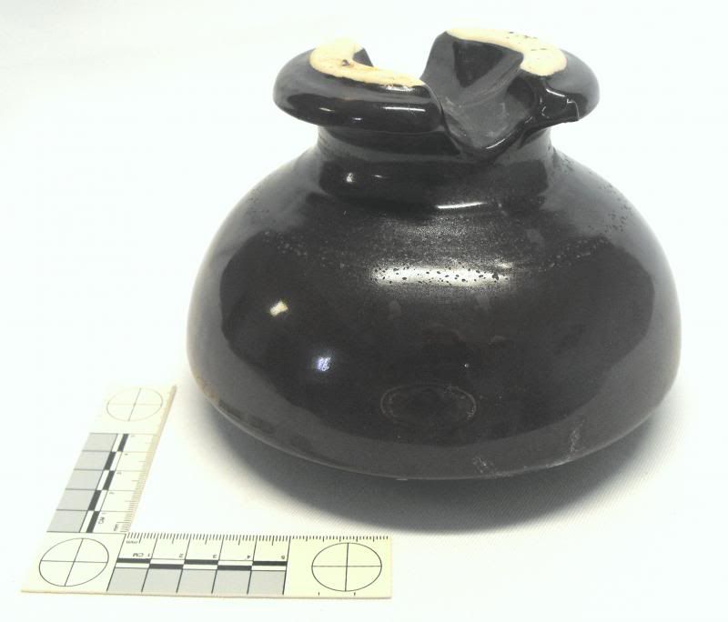

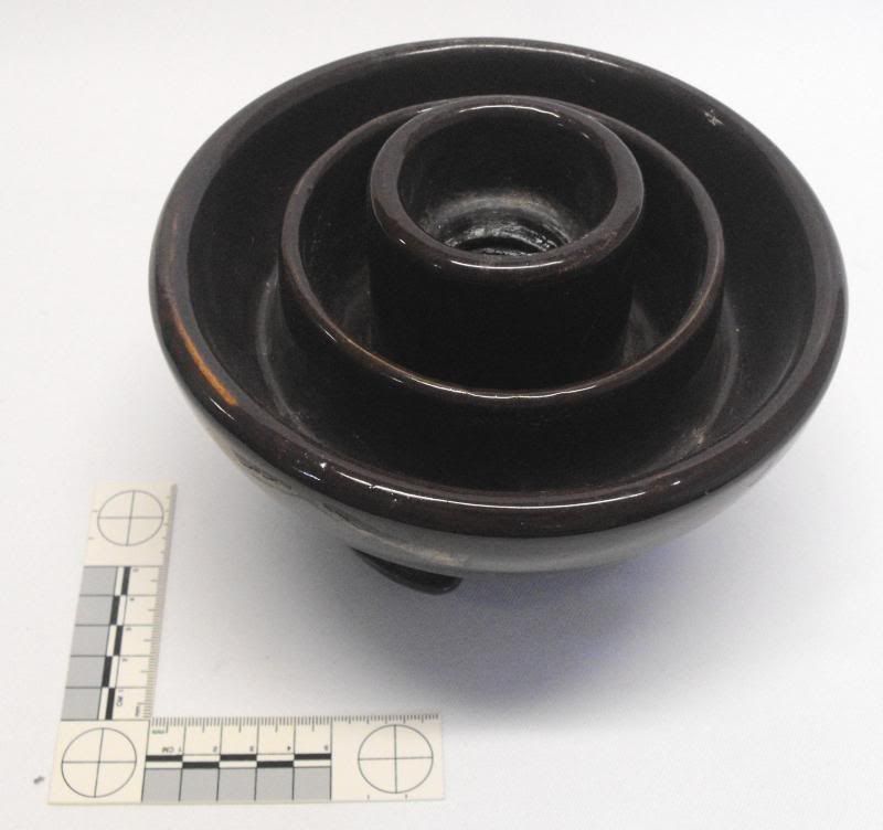

der5997 Posted May 22, 2014 Report Share Posted May 22, 2014 You folks have proved very helpful in the past with my Museum Research questions, and I'm back with another. I'm currently researching and cataloguing this screw type multi-skirt power line pole insulator. (Please correct my terminology, BTW, as I'm making up my own terms out of ignorance of the correct ones.) Could you please tell me the Voltage Range for an insulator such as this (My guess = 30-40KV) and the date (I know the screw base was discontinued, but don't know the time-frame.) Many thanks for consideration. Quote Link to comment Share on other sites More sharing options...
Marc Posted May 23, 2014 Report Share Posted May 23, 2014 I have no idea of the age but unless they were installed in stacks, it would likely handle no more than 2,400 volts line to ground, probably less. Marc Quote Link to comment Share on other sites More sharing options...

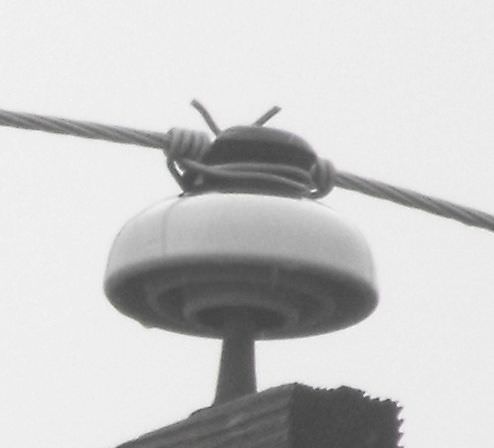

der5997 Posted May 23, 2014 Author Report Share Posted May 23, 2014 Thanks Mark: Not stacked, as there is a thread in the center for fixing to a power pole. I based my guess on voltage on the modern example on the power line outside our home (subdivision developed in the late 1990s) This pic is of one of three identical lines on cross trees on the power pole. Click to Enlarge 15.76 KB Quote Link to comment Share on other sites More sharing options...

Gardner Posted June 11, 2014 Report Share Posted June 11, 2014 I have no idea of the age but unless they were installed in stacks, it would likely handle no more than 2,400 volts line to ground, probably less. Marc Those in particular can go to at least 8kv phase to ground, possibly 15kv phase to ground if designed so. Smaller pin types usually only go to 5kv phase to ground. I frequently call those bowl insulators. They aren't meant to stack, rather they go unto a metal threaded pin often found on cross arms. A wire or rubber "tie down" is used to hold the wire in place. Quote Link to comment Share on other sites More sharing options...
