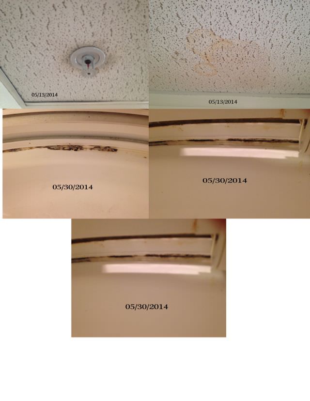

rozzy Posted May 31, 2014 Report Share Posted May 31, 2014 Hi there. Me and my wife moved into a new apartment about 1.5 weeks ago. And after only a couple of days i started to have rashes on my face, which has never happened ever in my life. We reported this instantly to the management company and I told them that there might be mold present. He respond with saying that i'm just probably reacting to our sheets or laundry detergent, (We've been using the same detergent for over a year). I bought a home mold test kit from Home depot which turned positive withing 24 hours after sampling the air from the central AC, and I also have these pictures of the ceiling covering the AC and from the bathroom. 24 hours prior to the mold inspector arriving, the on site manager in the entered our apartment, without any notice, and removed the covers that had traces of the leak & mold that was coming from the AC. And when the inspector came, he only sampled the air, and left after 5 minutes. Their air test turned negative. Luckily, i still have pictures of the covers from before and the bathroom. Now the landlord is trying to do everything he can to get rid of us because we're "annoying tenants that complains about mold". Just to clarify i'm not wrong. This is mold isn't it? And what should our next step be? Click to Enlarge 53.94 KB Quote Link to comment Share on other sites More sharing options...
rkenney Posted May 31, 2014 Report Share Posted May 31, 2014 Just to clarify i'm not wrong. This is mold isn't it? And what should our next step be? Click to Enlarge 53.94 KB Can't tell what it is from a picture. Just to clarify your question. You are asking a group of Home Inspectors for legal advice? Only a lawyer can tell you what your next step should be. Quote Link to comment Share on other sites More sharing options...

John Kogel Posted June 2, 2014 Report Share Posted June 2, 2014 I finally figured out the last three pics. That is dirt on silicone sealer around a shower enclosure. Yes the dirt will often grow mould (mold) and the solution is to remove the old silicone sealer and replace it. Clean the bathroom and you won't get the black dirt. It is normal for any older bathroom, especially one that is rented. Why, because renters tend to neglect the place, expecting the landlord to maintain everything. Yet they also tend to complain if the landlord wants to come in. So you get this type of thing - dirt. We see similar moldy dirt in the window channels. People that clean up their living spaces and wipe the dirt off once in a while don't get this kind of dirt. The stain around the sprinkler head could be moisture from a leak or condensation on the cold pipe. Those other stains, who knows? Replace the ceiling tiles if it is a concern. If you are reacting to those typical, minor stains, you will not find safe rental housing anywhere on the planet, IMO. Quote Link to comment Share on other sites More sharing options...
