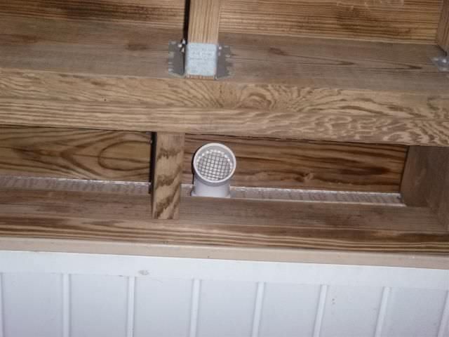

Bill Kibbel Posted June 12, 2014 Report Share Posted June 12, 2014 The instructions for the vent terminals are always very clear for Canadian installations: 12" under any veranda, porch, deck or balcony. For US installs it's always: "Maintain clearances in accordance with local installation codes and the requirements of the gas supplier". Does anyone have anything to prohibit this: Click to Enlarge 39.54 KB Quote Link to comment Share on other sites More sharing options...
John Dirks Jr Posted June 12, 2014 Report Share Posted June 12, 2014 How many BTU? The following says if it's over 10,000 but under 50,000, it needs 12" clearance. Look under © National Fuel Gas Code NFPA 54/ANSI z223.1 Section 7.8 pages 54-52 & 54-53 THROUGH THE WALL VENT TERMINATION (a) A mechanical draft venting system shall terminate at least 3 feet above any forced air inlet located within 10 feet. Exception No 1 Provision does not apply to combustion air intake of a Direct Vent appliance. Exception No 2 This provision shall not apply to the seperation of the integral outdoor air inlet and flue discharge of listed outdoor appliances. (b) A mechanical draft system of other than direct vent shall terminate at least 4 feet below, 4 feet horizontally from 1 foot above any door, window, or gravity air inlet into any building. the bottom of the vent shall terminate at least 12 inches above grade. © The vent terminal of a direct vent appliance with an input of 10,000 BTU's or less shall be located at least 6 inches from any air opening into the building, and such an appliance with input over 10,000 BTU but not over 50,000 BTU shall have at least 12 inches vent termination clearance. The bottom of the vent terminal and air intake shall be 12 inches above grade. (d) Through the wall vents for Category II and Category IV appliances and noncategorized condensing appliances shall not terminate over public walkways or over an area where condensate could create a nuisance hazard or could be detrimental to the operation of regulators, relief valves, or other equipment. Where local experince indicates that condensate is a problem with Category I and Category III appliances this provision shall also apply. In addition to those rules follow manufactureres instructions. Quote Link to comment Share on other sites More sharing options...

Tom Raymond Posted June 12, 2014 Report Share Posted June 12, 2014 A colored smoke bomb would clearly demonstrate how wrong it is. Quote Link to comment Share on other sites More sharing options...
Marc Posted June 12, 2014 Report Share Posted June 12, 2014 A colored smoke bomb would clearly demonstrate how wrong it is. Tell me again why it's wrong. It's condensing so it's not really hot. It discharges outdoors where it's not trapped and where there's abundant fresh air to disperse it. Marc Quote Link to comment Share on other sites More sharing options...
kurt Posted June 12, 2014 Report Share Posted June 12, 2014 Hot CO can pocket, build up, and find it's way into the building from pressure differentials. At least, that's how it was explained to me. There's also the *just plain ****ing stupid* violation. Stupid things are generally not allowed. Quote Link to comment Share on other sites More sharing options...
Les Posted June 12, 2014 Report Share Posted June 12, 2014 I live in an area that is cold abt 11 1/2months a year. all direct vents are visible most of the time. the condensation on the wood is a real issue for us. it seems to keep the wood wet with a liquid that is slightly acidic and of course it forms hoary frost for several months of the year on surrounding surfaces. Quote Link to comment Share on other sites More sharing options...
Tom Raymond Posted June 12, 2014 Report Share Posted June 12, 2014 The ACQ preservative is basic and the exhaust is acidic. They will neutralize one another and nothing bad will ever happen. Quote Link to comment Share on other sites More sharing options...
Bill Kibbel Posted June 13, 2014 Author Report Share Posted June 13, 2014 There's also the *just plain ****ing stupid* violation. Stupid things are generally not allowed. But in this case, only if it's installed in Canada! Quote Link to comment Share on other sites More sharing options...
Eric B Posted June 16, 2014 Report Share Posted June 16, 2014 the condensation on the wood is a real issue for us. Agreed. It's situations like this where I report based upon my experience and opinion - the heck with AHJ or manufacturer requirements. Quote Link to comment Share on other sites More sharing options...
