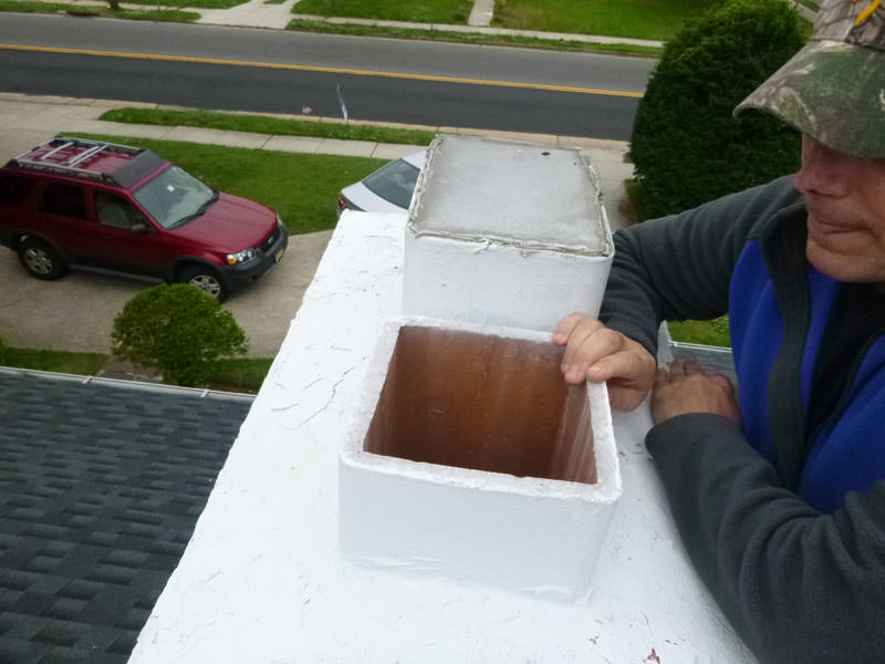

rbaake Posted June 12, 2014 Report Share Posted June 12, 2014 Hi Guys, Any comments on the venting of this water heater would be appreciated. Besides sharing a masonry chimney with a wood burning fireplace on the other side and questionable slope it seems a wye connector may be needed to vent it above the boiler. No evidence of back drafting but venting is newly installed. Thanks again, Roy Baake | Interspec, LLC Download Attachment: Photo X.jpg 87.56 KB Quote Link to comment Share on other sites More sharing options...
Jim Katen Posted June 13, 2014 Report Share Posted June 13, 2014 The wood burning fireplace venting through an adjacent flue has nothing to do with the venting in this flue. Ignore it. That set up has several problems. * Since this is a garage in a cold climate, the vent connectors should all be insulated, double-wall material. * Either the vent connector before the water heater is oversized or the one after the water heater is undersized. A properly sized vent connector will step up in size where a second appliance joins it. * Unless that's a really tall chimney, the horizontal portion of the vent connector is too long. Personally, I think that there's no advantage to a wye vs a tee in this application. The gases are being *sucked* out not *pushed* out. Tees work fine. Quote Link to comment Share on other sites More sharing options...
rbaake Posted June 13, 2014 Author Report Share Posted June 13, 2014 Thanks Jim, The fireplace and gas fired appliances both vent into a single clay lined flue. Two flues were noted at the chimney however, one is abandoned. Photo included below. Thanks Download Attachment: Photo 34.jpg 105.22 KB Quote Link to comment Share on other sites More sharing options...
Jim Katen Posted June 13, 2014 Report Share Posted June 13, 2014 Thanks Jim, The fireplace and gas fired appliances both vent into a single clay lined flue. Two flues were noted at the chimney however, one is abandoned. Photo included below. Thanks Download Attachment: Photo 34.jpg 105.22?KB Then it's wrong. You shouldn't have gas appliances venting into the same flue as a wood-burning appliance unless the equipment is designed that way. By the way, they must never have built a fire in that fireplace. I've never seen a fireplace flue liner that clean. Quote Link to comment Share on other sites More sharing options...
