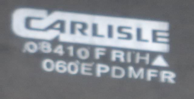

MPdesign Posted July 7, 2014 Report Share Posted July 7, 2014 This is a new age format (for me)! Thank you for your insight. Click to Enlarge 20.74 KB Quote Link to comment Share on other sites More sharing options...
Bill Kibbel Posted July 7, 2014 Report Share Posted July 7, 2014 Carlisle uses the last 2 letters. IH = '98 BTW, I highly recommend Carlisle's low-slope roof training. Quote Link to comment Share on other sites More sharing options...
MPdesign Posted July 7, 2014 Author Report Share Posted July 7, 2014 Thank you Bill, What is that training called? I made a search for it, but I am not having any luck. And is there an age lookup list so that I will know other dates? i.e. 1998 = IH 1999= ? etc Quote Link to comment Share on other sites More sharing options...
Nolan Kienitz Posted July 7, 2014 Report Share Posted July 7, 2014 H = 9 I = 8 Count the alphabet alphas ... A = 1 B = 2 C = 3 etc., BTW - I'm only guessing .... Quote Link to comment Share on other sites More sharing options...
Bill Kibbel Posted July 7, 2014 Report Share Posted July 7, 2014 Thank you Bill,What is that training called? I made a search for it, but I am not having any luck.And is there an age lookup list so that I will know other dates? i.e. 1998 = IH1999= ?etc A-I = 1-9. I don't remember what letter for zero.Carlisle does like 2 dozen seminars each year for EPDM and TPO. Most are in PA and Texas and a few way out west. I think they also present at other organizations' conferences. My contact was Michelle.Varner(at)syntec.carlisle.com.They have on-line courses too. I'll look for my bookmark when I get back in tonight.id="left"> Quote Link to comment Share on other sites More sharing options...
