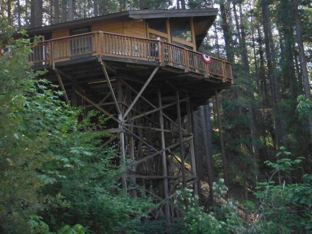

yesterdays inspection, 40 years old in snow country.
beside the obvious most of footings were not below frost line that I could tell. No evidence of movement though. Wood structure mostly nailed together, few lags or bolts... told them to get structural engineer to evaluate and offer remedies before closing.
great place from the deck up!

Snow piles up around the posts and helps to keep everything straight. [:)]
I think the builder knew what he was doing 40 years ago, but good call on your part.
