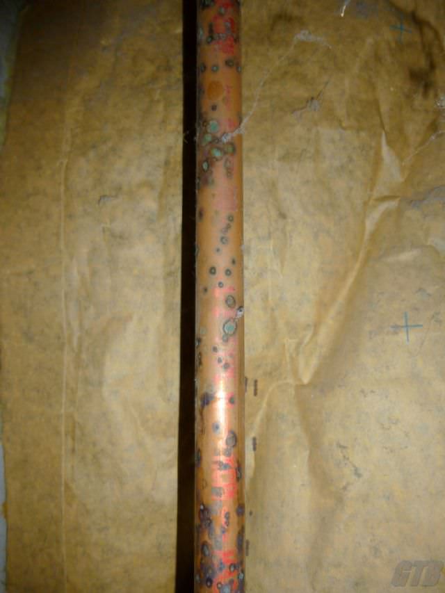

gtblum Posted July 13, 2014 Report Share Posted July 13, 2014 Type M copper lines to the laundry area, in a 13 year old, dry basement. Is this about to become a sprinkler system? Click to Enlarge 59.22 KB Click to Enlarge 74.32 KB Click to Enlarge 26.19 KB Quote Link to comment Share on other sites More sharing options...
ghentjr Posted July 13, 2014 Report Share Posted July 13, 2014 Some kind of electrical issue eating out the zinc? Low ph doing the same thing? Yes, it will probably be a sprinkler soon. Quote Link to comment Share on other sites More sharing options...
kurt Posted July 13, 2014 Report Share Posted July 13, 2014 Type M thinwall? Yeah, probably. Quote Link to comment Share on other sites More sharing options...
Marc Posted July 13, 2014 Report Share Posted July 13, 2014 Isn't type M allowed? Marc Quote Link to comment Share on other sites More sharing options...
kurt Posted July 13, 2014 Report Share Posted July 13, 2014 Sure it's allowed. It's just really thin and insubstantial. It can work fine. Or not. If you're serious with your copper, it's K or L. Quote Link to comment Share on other sites More sharing options...
Jim Katen Posted July 13, 2014 Report Share Posted July 13, 2014 If the corrosion is originating on the outside of the pipe, it's probably just superficial. If the corrosion is working its way out from the inside, it's toast. To find out, swipe a green Scotch Brite pad over it. If the corrosion is coming from the outside, it' burnish up nice & pretty. If the corrosion is coming from the inside, you'll have a wet Scotch Brite pad. Quote Link to comment Share on other sites More sharing options...
