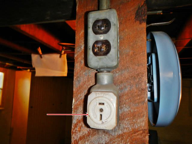

Robert Jones Posted July 16, 2014 Report Share Posted July 16, 2014 In the basement of a home built in 1927. Can't say I have seen this type of "outlet"? Click to Enlarge 46.94 KB Quote Link to comment Share on other sites More sharing options...
Bill Kibbel Posted July 16, 2014 Report Share Posted July 16, 2014 NEMA 2-20. Was originally, and probably still is, made by Hubbell. That one is Crouse-Hinds. 20 amp 240v no ground (hot-hot). Quote Link to comment Share on other sites More sharing options...
