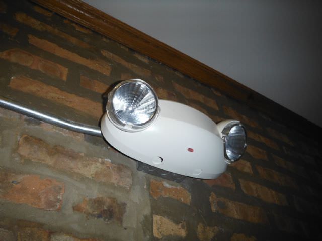

hoosier inspector Posted July 31, 2014 Report Share Posted July 31, 2014 Kurt, All the exit and emergency lighting that I've seen in Chicago (all metal const.) is manufactured by one company. Do you know any specifics? Quote Link to comment Share on other sites More sharing options...
kurt Posted July 31, 2014 Report Share Posted July 31, 2014 Geez, you got me. I look at them all the time, I must have a pic here somewhere...... I think you're right, though; one company. Quote Link to comment Share on other sites More sharing options...
Mike Lamb Posted August 1, 2014 Author Report Share Posted August 1, 2014 Kurt, All the exit and emergency lighting that I've seen in Chicago (all metal const.) is manufactured by one company. Do you know any specifics? They do all look the same. I press the test button when doing multi-units. Sometimes they work. Most of the time not. Click to Enlarge 17.54 KB Quote Link to comment Share on other sites More sharing options...
Jim Katen Posted August 1, 2014 Report Share Posted August 1, 2014 Kurt, All the exit and emergency lighting that I've seen in Chicago (all metal const.) is manufactured by one company. Do you know any specifics? They do all look the same. I press the test button when doing multi-units. Sometimes they work. Most of the time not. Click to Enlarge 17.54 KB When they don't work, it's usually because the battery is toast. Quote Link to comment Share on other sites More sharing options...

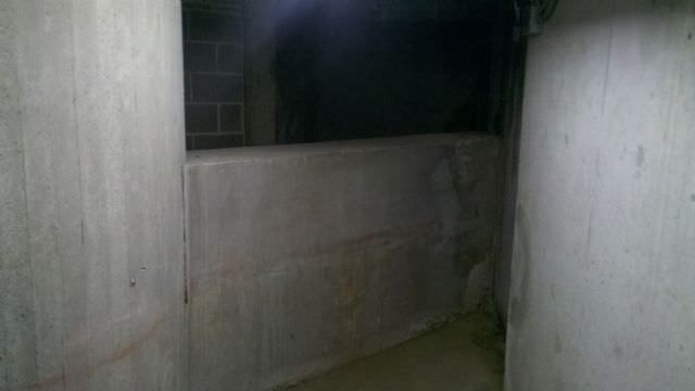

hoosier inspector Posted August 2, 2014 Report Share Posted August 2, 2014 I've heard a rumor that it's the only brand "approved" and all other company applications get "misplaced". I was just trying to get some more info. On an unrelated topic, I was in the basement of the Hilliard Towers (in China Town) and came across, what I was told, a conduit of the main electrical grid. It apparently could not be moved so they built the building on top of it. It literaly cuts through the middle of the basement. The maintenance staff built a bridge to get from one side to the other. I noted two observations; 1. It disappeared into the middle of a support column, and 2. the concrete was not dyed red. I think someone was pulling my leg. Could this be a hastily improvised design feature? Click to Enlarge 20.73 KB Click to Enlarge 34.39 KB Click to Enlarge 26.82 KB Usually you need to duck your head going under a bridge instead of over it. Quote Link to comment Share on other sites More sharing options...
kurt Posted August 2, 2014 Report Share Posted August 2, 2014 That could easily be real. Any older City urban infrastructure is a mish mash of craziness. They discovered some old copper bus in Evanston; about 6" in diameter solid copper housed in an old cedar log/box buried in an alley. When it blew, it was spectacular....intense greenish whitish bluish light just pulsing away...lotta damage, no one was hurt TG. Quote Link to comment Share on other sites More sharing options...

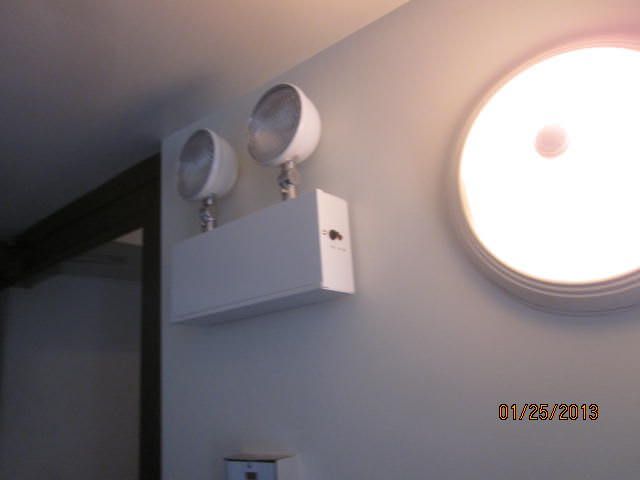

Mike Lamb Posted August 20, 2014 Author Report Share Posted August 20, 2014 Kurt, All the exit and emergency lighting that I've seen in Chicago (all metal const.) is manufactured by one company. Do you know any specifics? I saw this one yesterday. Plastic. And the test button was broken. Click to Enlarge 34.36 KB Quote Link to comment Share on other sites More sharing options...
hoosier inspector Posted August 22, 2014 Report Share Posted August 22, 2014 Kurt, All the exit and emergency lighting that I've seen in Chicago (all metal const.) is manufactured by one company. Do you know any specifics? I saw this one yesterday. Plastic. And the test button was broken. Click to Enlarge 34.36 KB I'll bet a dollar to your doughnut it doesn't have an approval sticker on it. Quote Link to comment Share on other sites More sharing options...
