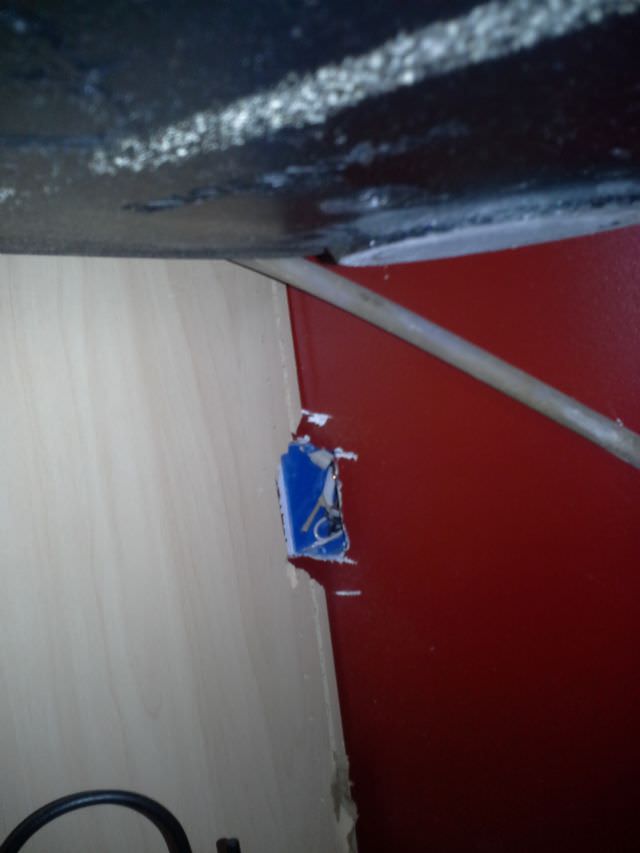

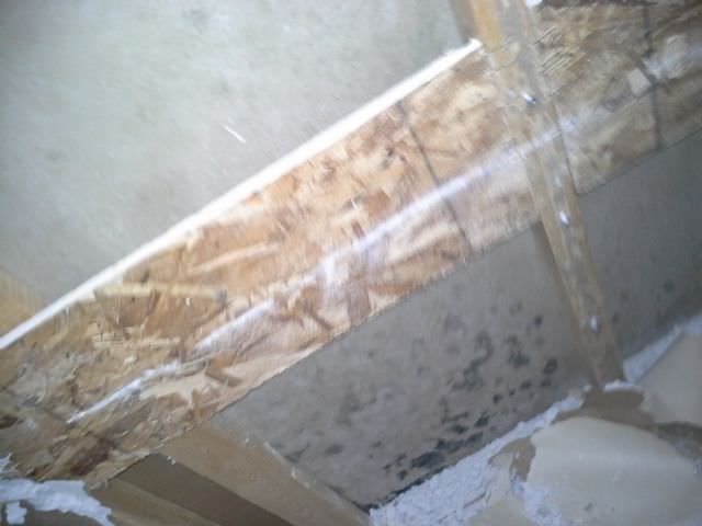

plummen Posted August 9, 2014 Report Share Posted August 9, 2014 A lady I know called me about an inspection she had done on a property she wanted to buy. She wasn't quite sure about what the inspector found and wanted me to look at some electrical issues he had listed. Before I could even get inside I was hit right in the face by lots of stuff that didn't look right to me,but didn't seem to bother the home inspector. Im no carpenter,but feel free to let me know if this stuff looks right to you. Click to Enlarge 90.5 KB Click to Enlarge 65.57 KB Click to Enlarge 37.97 KB The bottem picture is the plug box that he wrote up for being in between the dishwasher and under sink area because some clown couldn't read a tape measure,he didn't notice the boot legged plumbing coming up through base of cabinet for some reason though. Other pictures are from deck on rear of house which is built from a combition of pressure treated and untreated pine lumber sitting on dirt with no footings and no real support for steps. His note said deck material needs to be treated/stained![:-censore Quote Link to comment Share on other sites More sharing options...

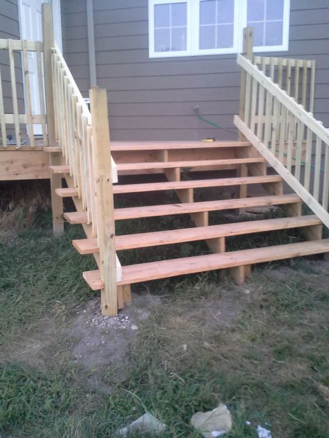

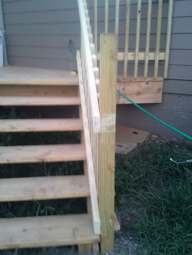

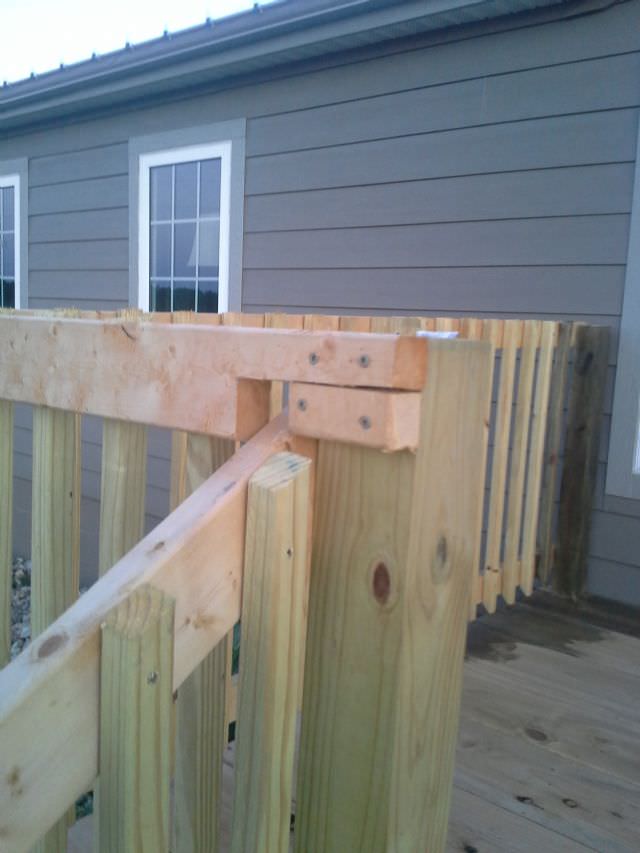

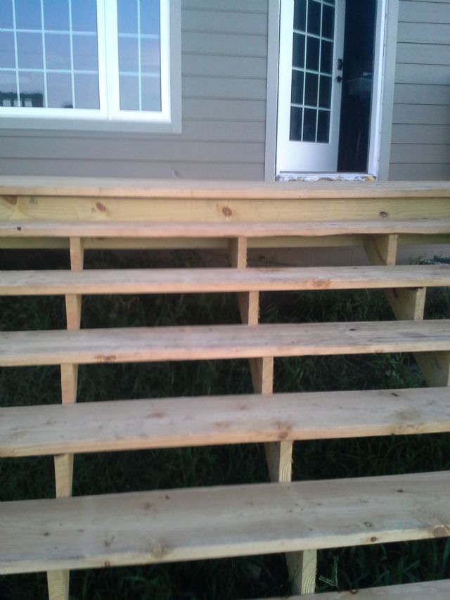

plummen Posted August 9, 2014 Author Report Share Posted August 9, 2014 Click to Enlarge 37.84 KB Click to Enlarge 63.57 KB Click to Enlarge 65.19 KB Click to Enlarge 56.65 KB Click to Enlarge 66.06 KB The top picture is from behind a bathroom cabinet that was just sitting there that the home inspector apparently didn't want to move,sure looks like mold to me anyway.[:-yuck] The other shots are from deck on front of house. Inspector wrote up trim on front door needs repaired,gee ya think? Zoom in on the door for a good laugh![:-weepn] again he didn't notice the pine lumber on front deck,steps without support generally hacked up work. Again ,he said lumber needed to be treated to preserve it. I was so bent out of shape after seeing this property that I actually had the county inspector come out and threaten to condemn it. So you see there is a huge difference between an inspector who knows what hes looking at and a clown in a pickup truck. The same goes for contractors.[] Quote Link to comment Share on other sites More sharing options...

gtblum Posted August 9, 2014 Report Share Posted August 9, 2014 I am a carpenter, I own a pickup truck, and if you read some of the wise ass remarks I've posted, also part clown. The deck ain't pretty. I'll give you that. From what we can see, it needs correction. I can't see any untreated lumber in the dirt. I'll take your word for it. As far as using a combination of treated and untreated lumber anywhere else, stain it and walk away. I'm one of those guys who hates treated for anything other than ground contact. Quote Link to comment Share on other sites More sharing options...

mjr6550 Posted August 10, 2014 Report Share Posted August 10, 2014 I am a carpenter, I own a pickup truck, and if you read some of the wise ass remarks I've posted, also part clown. The deck ain't pretty. I'll give you that. From what we can see, it needs correction. I can't see any untreated lumber in the dirt. I'll take your word for it. As far as using a combination of treated and untreated lumber anywhere else, stain it and walk away. I'm one of those guys who hates treated for anything other than ground contact. The codes I'm familiar with generally require treated wood or decay resistant wood for decks, regardless of whether it is at or near the ground. Quote Link to comment Share on other sites More sharing options...

Jim Baird Posted August 11, 2014 Report Share Posted August 11, 2014 Gary I see what looks like spruce lumber on the handrail assemblies. The spans on one flight are way over for the treads. Re the county guy I never heard of an AHJ willing to visit unless there was an urgent safety concern. The deck is very sloppy and substandard, and will rot/fall apart in short time, but is not imminent hazard. While I served as AHJ underbuilt decks were one of the most common problems. I am a carpenter, I own a pickup truck, and if you read some of the wise ass remarks I've posted, also part clown. The deck ain't pretty. I'll give you that. From what we can see, it needs correction. I can't see any untreated lumber in the dirt. I'll take your word for it. As far as using a combination of treated and untreated lumber anywhere else, stain it and walk away. I'm one of those guys who hates treated for anything other than ground contact. Quote Link to comment Share on other sites More sharing options...
gtblum Posted August 11, 2014 Report Share Posted August 11, 2014 Gary I see what looks like spruce lumber on the handrail assemblies. The spans on one flight are way over for the treads. Re the county guy I never heard of an AHJ willing to visit unless there was an urgent safety concern. The deck is very sloppy and substandard, and will rot/fall apart in short time, but is not imminent hazard. While I served as AHJ underbuilt decks were one of the most common problems. I am a carpenter, I own a pickup truck, and if you read some of the wise ass remarks I've posted, also part clown. The deck ain't pretty. I'll give you that. From what we can see, it needs correction. I can't see any untreated lumber in the dirt. I'll take your word for it. As far as using a combination of treated and untreated lumber anywhere else, stain it and walk away. I'm one of those guys who hates treated for anything other than ground contact. I was trying to be nice about describing that POS. I'm just not a fan of treated lumber. While we're sort of on the subject of decks, anybody else seen or worked with this latest, greatest, answer to replacing rotted trex? Tuff deck? A project I'm trying to wrap up for someone. The material is like licorice when it gets warm. Butted end joints opened to a quarter inch, two days after I installed it. I may have compromised the integrity of the frame with the weight of the blocking I had to have to support the pattern. Don't be picking on the off colored piece. it was replaced. Click to Enlarge 50.27 KB Quote Link to comment Share on other sites More sharing options...
Tom Raymond Posted August 11, 2014 Report Share Posted August 11, 2014 Composites expand and contract along their length. The good ones return to their original size. The bad ones shrink. They expand 1/4" and contract 5/16". The really bad ones expand in all directions so you not only get the gaps when they contract, but they push their neighbors off the deck. I had a Tendura porch do it and it was covered. The untreated lumber in the OP will be fine. There is so much else wrong with that deck that it will fall down long before the spruce railings rot out. Quote Link to comment Share on other sites More sharing options...
