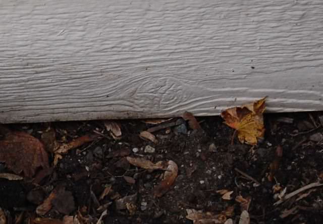

David Meiland Posted August 23, 2014 Author Report Share Posted August 23, 2014 Thanks all for the insights. My comments about getting kicked out are in jest... just wanting to clarify what my role is. I am often called to follow up on HIs. When you guys write "have a contractor look at this" I frequently get that call. I am asked for pricing on repair/replacement, and frankly, I often encounter stuff that was not in their report, so I have to decide where to go with that. I am there to look out for the financial exposure of the prospective buyer. The siding I saw did not have exposed fasteners, or at least any that I could see. It appeared to be blind nailed, and it definitely appeared to be recently painted. Given the imprint on this stuff, it seems like it would be hard to disguise swelling/crumbling etc. This place has been through a few failed deals recently and no amount of sleight-of-hand by the seller would surprise me. In any case, the siding "looks" good in most places, certainly not swollen or growing 'shrooms. I was able to determine that an addition was built post 1985 and at that time the siding *may* have been replaced. Possibly the first potential buyer I talked to was freaking out over nothing. The photo shows what appears to be the "LP knot" along with some faulty grade. Per Jim Katen's comment, I assume it's hard to date the material without removing some to see a stamp on the back (if that's even possible). Click to Enlarge 59.01 KB Quote Link to comment Share on other sites More sharing options...
David Meiland Posted August 23, 2014 Author Report Share Posted August 23, 2014 Photo doesn't enlarge much... Click to Enlarge 51.86 KB Quote Link to comment Share on other sites More sharing options...
Brandon Whitmore Posted August 23, 2014 Report Share Posted August 23, 2014 That LP looks like it should be rotted/ damaged along the faulty grade area, and likely from the slab level down where sandwiched. Paint and caulk doesn't hide the damage on that stuff. Just start pushing on it with your finger. Also, squeeze the bottom edges with the siding pinched between your thumb and index finger. Any softness will be felt quite easily. Quote Link to comment Share on other sites More sharing options...
kurt Posted August 23, 2014 Report Share Posted August 23, 2014 Putting the stuff in contact with cement, or really, just about anything...is the death knell, or so says the mfg. There's no clearances in those pics...not that I can see anyway. And the other thing....to quote the Simpson's.......civil war reenactor..."Hey, they're tryin' to learn' for free!!".....crowd...."Get them!" We're an equal opportunity disparagement and dismissal society....everyone is welcome to join and have their opinions insulted. Or not. Depends on whether the opinions carry water. Quote Link to comment Share on other sites More sharing options...
Jim Katen Posted August 23, 2014 Report Share Posted August 23, 2014 The LP in those picture is in excellent condition. Most installations from 1985 would have turned to mulch long ago. I've observed that some batches of the stuff were pretty good. A few (very few) installations seem to perform just fine, even without good maintenance and even when badly installed, as the stuff in your pictures. Most of it, however, went to hell within a few years - even if impeccably installed and maintained. I think that they had a serious quality control issue, which they seem to have mostly resolved by about 1998. Of course, by then it was too late. No one would trust the stuff. If the stuff in the pictures isn't soft in those locations, then I wouldn't fault the second inspector for not mentioning it. If the stuff has lasted this long under those conditions, what's the problem? Quote Link to comment Share on other sites More sharing options...

David Meiland Posted August 23, 2014 Author Report Share Posted August 23, 2014 This stuff hardly looks 30 years old to me. I'm gonna go with (1) the first prospective buyer I talked to got me on the wrong foot by describing a big problem, and (2) when they did the addition (or sometime after) they resided the house. I will inform the current buyer that this product has had a history of problems, but not all of it has problems; I cannot tell its age but my guess it that it is not original; it looks great right now because it was just painted; one of us could research the permit history and possibly learn more; and, she should budget X$ to fix that area with the slab contact. To find out more, I'd have to take some off the wall. Quote Link to comment Share on other sites More sharing options...
