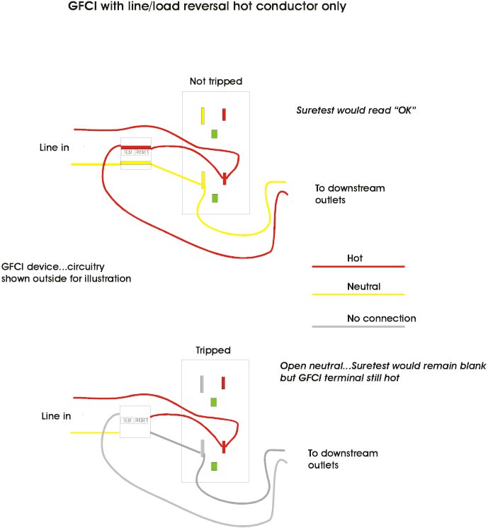

Scottpat Posted November 9, 2005 Author Report Share Posted November 9, 2005 At an inspection yesterday the Fluke was still glowing after the GFCI tripped. I thought that it could be a bad GFCI, but it happened on 4 other GFCI outlets as well. On the back of the GFCI if the Load/Line are reversed wouldn't this cause the Fluke to still glow after the GFCI is tripped? I could not get my SureTest to show anything after it tripped (showed everything OK before trip), and my multimeter was on the fritz(battery leaked inside the case). Quote Link to comment Share on other sites More sharing options...

Richard Moore Posted November 9, 2005 Report Share Posted November 9, 2005 Scott... The Suretest will have no display for an open neutral. Is it possible that only the hot (not the neutrals) conductors were reversed? I believe that would result in an open neutral once the GFCI was tripped (but normal readings otherwise). Hard to imagine they would do that at 4 GFCI's, but I guess if someone got it in their head that that was the way to hook them up... Quote Link to comment Share on other sites More sharing options...
Richard Moore Posted November 9, 2005 Report Share Posted November 9, 2005 Slow day...so I came up with this to check my thinking... Download Attachment: partiallineloadreverse.jpg 55.31 KB Would only "work" on older GFCIs. I don't think the new ones would reset. Quote Link to comment Share on other sites More sharing options...
Scottpat Posted November 9, 2005 Author Report Share Posted November 9, 2005 That helps, and I bet that is the problem. It did have the older GFCI outlets and not the new ones that will not reset if wired wrong. Thanks Quote Link to comment Share on other sites More sharing options...

Scottpat Posted November 29, 2005 Author Report Share Posted November 29, 2005 I've had it happen a couple of times since I started this thread, the last time(yesterday on new constriction) I removed the outlet from the wall and found the line/load connections were reversed. These were the older style GFCI's not the newer ones that will not reset if wired improperly. I did an inspector No No and changed the connections and Voilà ! The volt stick did not light up this time when I placed it in the tripped outlet. So my infield test show that a volt stick (I use the Fluke brand)will light up if it is inserted into a tripped GFCI outlet that has the line/load reversed. I also noticed that light on the volt stick was not as bright when the outlet was tripped compared to when it was not tripped. Quote Link to comment Share on other sites More sharing options...
