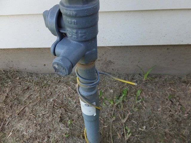

Marc Posted August 26, 2014 Report Share Posted August 26, 2014 There's this wire that's wrapped around the gas riser feeding today's house. It's just dangling there, having risen out of the earth along with the pipe. Is it supposed to be bonded? Click to Enlarge 64.31 KB Marc Quote Link to comment Share on other sites More sharing options...
inspector57 Posted August 26, 2014 Report Share Posted August 26, 2014 There's this wire that's wrapped around the gas riser feeding today's house. It's just dangling there, having risen out of the earth along with the pipe. Is it supposed to be bonded? Click to Enlarge 64.31 KB Marc That is a tracer wire to help locate the buried plastic pipe, not a bonding wire. Quote Link to comment Share on other sites More sharing options...

Mark P Posted August 26, 2014 Report Share Posted August 26, 2014 Interesting timing on this post - I just recieved an e-mail from a customer complaining that the gas meter ground wire was not connected. Thread Drift - This is a good example on why I like my customers to attend the inspection, so they can ask these questions during the inspection and not complain about some none issue later. Quote Link to comment Share on other sites More sharing options...
Speedy Petey Posted August 26, 2014 Report Share Posted August 26, 2014 That is a tracer wire to help locate the buried plastic pipe, not a bonding wire. Yup, many utilities are going to poly gas pipe these days. Quote Link to comment Share on other sites More sharing options...
