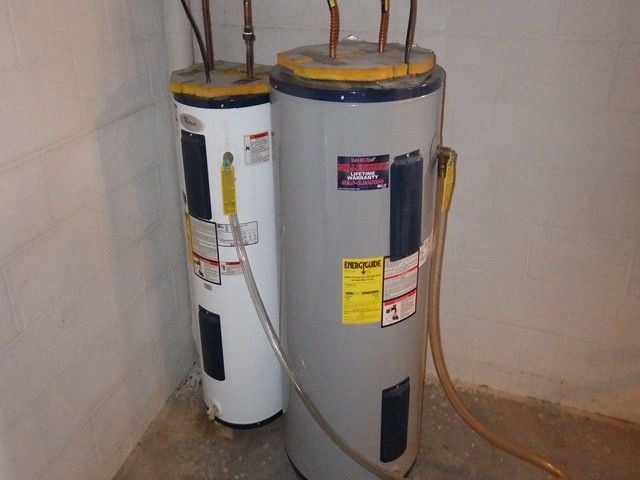

Erby Posted September 6, 2014 Report Share Posted September 6, 2014 Here's some drain tubes for you! Click to Enlarge 42.18 KB Quote Link to comment Share on other sites More sharing options...
Nolan Kienitz Posted September 6, 2014 Report Share Posted September 6, 2014 The insulation caps are cute !!! [^] Quote Link to comment Share on other sites More sharing options...
