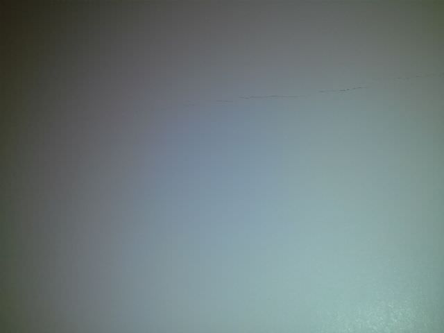

krishmunn Posted September 16, 2014 Report Share Posted September 16, 2014 We are buying a 1963 Single Family Raised Ranch. Inspection was done . Here are the problems which he cited but did not list any of these as major concern. 1) The upper level Ceiling is cracked in more than one place. The cracks are from one wall of house to other . Also, there are some horizontal cracks on walls (drywall) . House was recently painted (to hide issues I believe ?) . Is this a structural issue ? Attic is not very accessible (through a closet and has no floor to walk on). The house had a new roof if that helps 2) The floor tiles of upper level bath are cracked . I am handy enough to replace tiles but wondering if it is a structural problem . 3) Lower level bathroom door frame and some trim has water stains and high moisture. Seller says his children were playing with water . But even 3 days after he stopped using that bath, I found very high moisture using my moisture meter. No other area shows moisture but I would add that all trim are newly replaced. Wondering if it is just a drain pipe leaking or water from ground. Quote Link to comment Share on other sites More sharing options...

Robert Jones Posted September 16, 2014 Report Share Posted September 16, 2014 Any chance you have some photo's of the cracks? Exterior? Tough from the description to determine if they are settlement cracks, crappy drywall job or a structural type issue. Quote Link to comment Share on other sites More sharing options...
John Dirks Jr Posted September 16, 2014 Report Share Posted September 16, 2014 Drywall cracks may or may not indicate concerns. Could be poor cosmetics or could be indication of movement in the structure. To know either way, I would need to see them myself, or, at least see some good pictures. If you are coming out of this process with unanswered questions, it's clear the inspector did a poor job of communicating with you. I know for sure that describing things in an inspection report with single words is way below par. Quote Link to comment Share on other sites More sharing options...

krishmunn Posted September 16, 2014 Author Report Share Posted September 16, 2014 Thanks for all help. I am trying to attach some photos. The wall concerned is interior drywall. The exterior foundation wall looks good (except some stucco coming loose) . Click to Enlarge 32.53 KB Click to Enlarge 23.24 KB Click to Enlarge 11.26 KB Click to Enlarge 47.77 KB Quote Link to comment Share on other sites More sharing options...
Robert Jones Posted September 16, 2014 Report Share Posted September 16, 2014 The cracked floor tile appears to be just that, a cracked floor tile. Almost looks as if something dropped on it. If that is marble, and not installed correctly, it will crack. I can't tell much from the drywall pics. The pic of the wood trim. It's tough but, it looks as if water has wicked up quite a ways. It looks darket to me from the floor to about 8". If the inspector was getting a high moisture reading(did he/she use a moisture meter?), I would pull the wood trim to make sure it's not anything serious behind there. Quote Link to comment Share on other sites More sharing options...

Garry Sorrells Posted September 16, 2014 Report Share Posted September 16, 2014 The ceiling crack may be the result of the truss/rafter/joist design and how the drywall was installed, flexing and moving. If that is the case unless you make design alterations it will always have a crack. Not a structural integrity issue just a cosmetic issue. If only a tile or two, most likely failed from installation or something hitting it. The water on trim. Seller would never lie to yo would they? From pict it looks like it is not a one time event. Therefore potential concern. Your HI and a check list report only makes for a bad report. Fewer words will protect the HI. All the HI has to say ; see it noted a potential problem. More words, narrative report with meaningful explanations, would be better for the client yet it would dig a hole for the HI if they were not competent. In your case it seems that you were short changed. Quote Link to comment Share on other sites More sharing options...
hausdok Posted September 16, 2014 Report Share Posted September 16, 2014 It would help a great deal if you were to edit your comment and do something to differentiate your words from the inspectors. All drywall eventually cracks at the taped joints and if the drywaller wasn't really skilled it can happen all through a house instead of at a few places. That house is half a century old and probably should have had the joints gone over and refeathered several times by now. That probably didn't happen. If he didn't mark it as an issue he probably needs to find a way to show in his report that he considers it to be a cosmetic issue that really isn't his purview - same with the cracked tiles. ONE TEAM - ONE FIGHT!!! Mike Quote Link to comment Share on other sites More sharing options...
