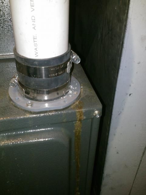

gfield Posted September 23, 2014 Report Share Posted September 23, 2014 The photo below shows something I've never seen before, in my somewhat limited experience with HE furnaces: The rust streak shown streams down from the exhaust tubing for the furnace. What problem, if any, does this indicate? Thanks! Quote Link to comment Share on other sites More sharing options...

Jim Katen Posted September 24, 2014 Report Share Posted September 24, 2014 I see condensate leaks from various parts of HE furnaces several times a week. Look at it carefully from both the outside and the inside of the cabinet to find the source of the leak. If you can't see one, consider the possibility that it has nothing to do with the furnace. Maybe the cat threw up from the shelf above the furnace. Quote Link to comment Share on other sites More sharing options...
gfield Posted September 24, 2014 Author Report Share Posted September 24, 2014 I see condensate leaks from various parts of HE furnaces several times a week. Look at it carefully from both the outside and the inside of the cabinet to find the source of the leak. If you can't see one, consider the possibility that it has nothing to do with the furnace. Maybe the cat threw up from the shelf above the furnace. Jim: I did look at it from inside and out. No obvious source that I could find, but its sure seemed to be leaking out from under the flange to which the plastic pipe attaches, as there is rust staining under the flange. So, IMO, that rules out the cat theory. [:-graduat Thank-you for your help. It is an honor and a real education to monitor this forum and learn and learn and learn and learn. I am humbled and learn something every day. Quote Link to comment Share on other sites More sharing options...
mjr6550 Posted September 24, 2014 Report Share Posted September 24, 2014 Could be condensate leaking from under the flange. I do not see a screw in the flange at the area where the stain is. Quote Link to comment Share on other sites More sharing options...
kurt Posted September 24, 2014 Report Share Posted September 24, 2014 When you check out the fittings on these things, it's remarkable how often you find problems. That said, I don't see nearly the number of problems Katen describes. I'd open the case and look on the inside. Quote Link to comment Share on other sites More sharing options...
David Meiland Posted September 24, 2014 Report Share Posted September 24, 2014 A certain amount of condensate is expected to drain back out of the flue, and outdoors via a drain connected near the bottom of the furnace. Maybe that rubber coupling just needs to be a little tighter. Quote Link to comment Share on other sites More sharing options...
gfield Posted September 24, 2014 Author Report Share Posted September 24, 2014 Could be condensate leaking from under the flange. I do not see a screw in the flange at the area where the stain is. Correct. I removed the screws, though, and had just not put them back at that point in time. Thank-you for responding. Quote Link to comment Share on other sites More sharing options...

kurt Posted September 24, 2014 Report Share Posted September 24, 2014 It's a good idea to check the vent pipes all the way to the exterior. I find them with failed joints fairly often. Quote Link to comment Share on other sites More sharing options...
John Kogel Posted September 24, 2014 Report Share Posted September 24, 2014 Is it just me or are we overworking this item? Condensation is normal, warm exhaust hits a cold pipe. The vent should be angled back to the furnace, seems to be. A connection has leaked a bit over the 6 years. It possibly has been repaired or maybe the clamp or flange is still loose. Call for the furnace to be serviced, always a good idea when someone buys a new house. But I would not be removing furnace components during a home inspection. Especially if you are not familiar with it. Let the repair guy see it in its untampered-with condition. What if you drop a screw, tear the gasket, strip threads in the housing, etc, etc. Quote Link to comment Share on other sites More sharing options...

Jim Katen Posted September 24, 2014 Report Share Posted September 24, 2014 . . . That said, I don't see nearly the number of problems Katen describes.. . . I'm amazed. Honestly, easily 80% (maybe even 90%) of the HE furnaces that I look at have condensate leaks, either at the collector box, the draft fan, or the plastic exhaust piping. I've seen two HE furnaces so far this week, and both were leaking. Quote Link to comment Share on other sites More sharing options...
