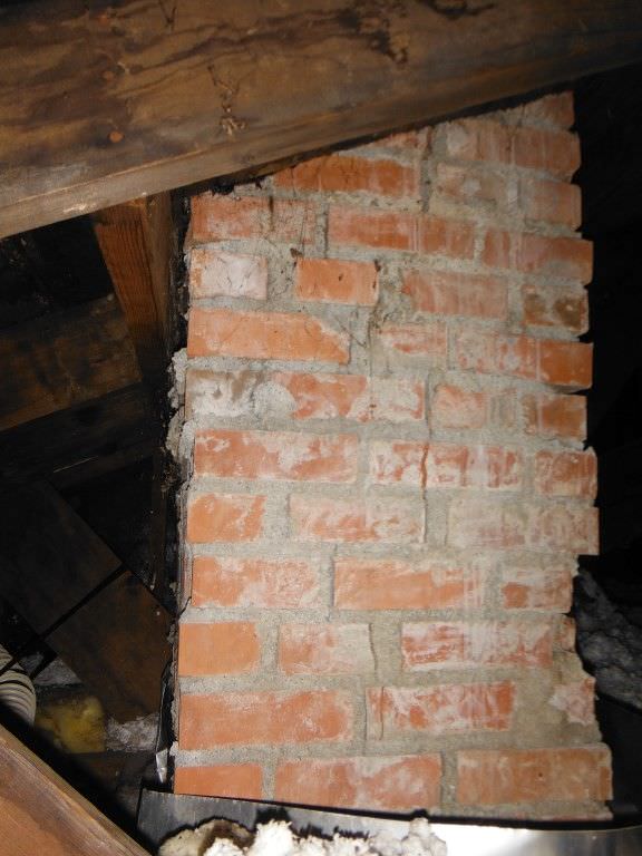

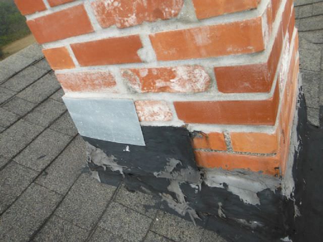

Denray Posted October 7, 2014 Report Share Posted October 7, 2014 Looks like the chimney was rebuilt above the roof. Now has an insert with its own flue liner. Inside the attic there is a long vertical crack. Should I be worried about this out here in earthquake country? Click to Enlarge 58.36 KB Click to Enlarge 75.23 KB Quote Link to comment Share on other sites More sharing options...
Jim Katen Posted October 8, 2014 Report Share Posted October 8, 2014 The chimney's coming down in the right earthquake. The crack don't make no never mind. Quote Link to comment Share on other sites More sharing options...
Denray Posted October 8, 2014 Author Report Share Posted October 8, 2014 I figered as much. Tanks for the reply. Quote Link to comment Share on other sites More sharing options...

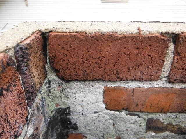

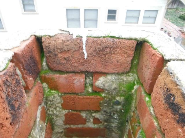

Denray Posted January 19, 2015 Author Report Share Posted January 19, 2015 Brutal! But, on another note, check out the degradation of these two old chimneys. Click to Enlarge 87.29 KB Click to Enlarge 60.49 KB Quote Link to comment Share on other sites More sharing options...
mjr6550 Posted January 20, 2015 Report Share Posted January 20, 2015 Brutal! But, on another note, check out the degradation of these two old chimneys. Click to Enlarge 87.29 KB Click to Enlarge 60.49 KB They didn't look much better than that when they were new. Quote Link to comment Share on other sites More sharing options...
