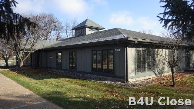

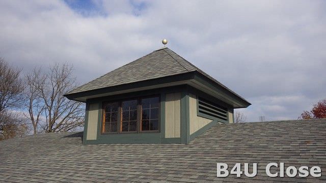

Erby Posted November 16, 2014 Report Share Posted November 16, 2014 7500 square foot building with soffit vents around the exterior and one large cupola in the center of the roof with vents on the side of the cupola. I'm thinking ridge vents would be a better solution. Your thoughts? Overview 64.38 KB Cupola 42.69 KB Attic opening into cupola 43.5 KB Quote Link to comment Share on other sites More sharing options...

Marc Posted November 16, 2014 Report Share Posted November 16, 2014 I think that because the openings in the cupola are slightly higher than the ridge, a ridge vent would not make an improvement. Think of the effect of flue height in regard to draft. Marc Quote Link to comment Share on other sites More sharing options...
Chad Fabry Posted November 16, 2014 Report Share Posted November 16, 2014 The cupola is a ridge vent. Quote Link to comment Share on other sites More sharing options...

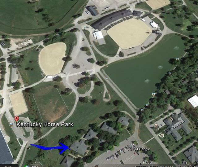

Erby Posted November 16, 2014 Author Report Share Posted November 16, 2014 Commercial office building with six bathrooms and one kitchen as moisture sources. I guess it seems to be working okay. It's location within a complex has some architectural requirements for matching other buildings. They're all done the same way. Click to Enlarge 73.04 KB Quote Link to comment Share on other sites More sharing options...

Jim Katen Posted November 17, 2014 Report Share Posted November 17, 2014 Commercial office building with six bathrooms and one kitchen as moisture sources. I guess it seems to be working okay. It's location within a complex has some architectural requirements for matching other buildings. They're all done the same way. There'll be no significant cooking or bathing and no laundering. Really no moisture to speak of. In the picture, it looks like the cupola spans a rated wall in the attic. If so, there might be a concern about fire. Quote Link to comment Share on other sites More sharing options...
