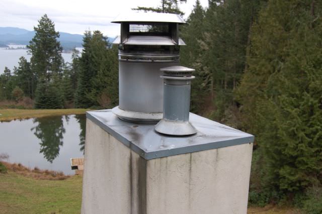

Mark P Posted December 26, 2014 Report Share Posted December 26, 2014 What is your opinion on the furnace venting so close to the fireplace flue. The rusted chimney cap is a given. I've never seen this before. What would you say about this. I'm still working on the report my rough draft reads as follows "Employ a chimney sweep and/or HVAC contractor to evaluate, and correct as neded, the furnace and fireplace flue termination. I believe they are to close and not in accordance with building standards. The fireplace flue should terminate 2 feet higher than anything within 10 feet?.. " Click to Enlarge 43.11 KB Quote Link to comment Share on other sites More sharing options...

Mark P Posted December 26, 2014 Author Report Share Posted December 26, 2014 Okay thanks, short and concise it is. For my benefit and the benefit of others can we list (discuss) what is wrong with this situation. I've looked a thousands of these framed chases with the sheet metal tops. It is not uncommon to find them rusted. What I have never seen is a furnace flue coming out the top of one. Also I've never seen a furnce and fireplace flue so close together. 1. The corrosive nature and high moisture content of the furnace exhaust is causing the sheet metal to rust. 2. The two flues terminate too close to one another. 3. ......? Quote Link to comment Share on other sites More sharing options...

Les Posted December 26, 2014 Report Share Posted December 26, 2014 Mark I am on my phone so can't see photo so good. One thing I did note was how does a rust streak appear on the left side of chase and the water not appear somewhere down stream? How much restriction is created by the left flue (B vent?) being close to metal? is there a brake line in the top pan? has the left flue settled? and anecdotally, I would not have written the being close. I see that all the time and unless there is evidence of a problem, it would not be written. I would want to carefully walk around this chase. Hope other contribute. Quote Link to comment Share on other sites More sharing options...
Bill Kibbel Posted December 26, 2014 Report Share Posted December 26, 2014 The primary issue is not the proximity of the furnace vent termination to the fireplace flue outlet. There are many, many masonry chimneys that have gas or oil equipment flues terminating just a couple inches from fireplace flue openings at the same elevation. There would have to be other issues for this to actually be a problem. The first issue is the B-vent for the furnace is supposed to terminate at least 12" from the top of the chase. Both vent pipes are supposed to be properly flashed at the chase cover, including storm collars. The sheet metal chase cover (if it was even galvanized) is overdue for replacement (with stainless steel and drainage slopes). I would also advise that someone get inside the chase to find the other likely installation errors. Quote Link to comment Share on other sites More sharing options...

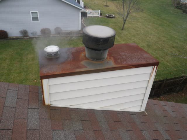

David Meiland Posted December 26, 2014 Report Share Posted December 26, 2014 How about this one? Is the direct vent FP close enough to breathe in the wood smoke, and does it matter? Click to Enlarge 45.1 KB Quote Link to comment Share on other sites More sharing options...
Erby Posted December 26, 2014 Report Share Posted December 26, 2014 If three flues in one chimney isn't a problem, why would those be a problem. Click to Enlarge 81.01 KB Quote Link to comment Share on other sites More sharing options...
Mark P Posted December 27, 2014 Author Report Share Posted December 27, 2014 The primary issue is not the proximity of the furnace vent termination to the fireplace flue outlet. There are many, many masonry chimneys that have gas or oil equipment flues terminating just a couple inches from fireplace flue openings at the same elevation. There would have to be other issues for this to actually be a problem. The first issue is the B-vent for the furnace is supposed to terminate at least 12" from the top of the chase. Both vent pipes are supposed to be properly flashed at the chase cover, including storm collars. The sheet metal chase cover (if it was even galvanized) is overdue for replacement (with stainless steel and drainage slopes). I would also advise that someone get inside the chase to find the other likely installation errors. Thanks Bill, that was a learning experience. Quote Link to comment Share on other sites More sharing options...
