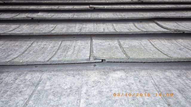

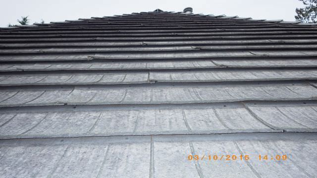

Robert Jones Posted March 11, 2015 Report Share Posted March 11, 2015 I can't say that I have ever seen these. Home built in 1993, looked like thick cardboard. Anyone familiar with them? Name? Click to Enlarge 52.79 KB Click to Enlarge 49.35 KB Quote Link to comment Share on other sites More sharing options...
LeePlace Posted March 11, 2015 Report Share Posted March 11, 2015 It Looks like Hardy Panel. Quote Link to comment Share on other sites More sharing options...
Robert Jones Posted March 11, 2015 Author Report Share Posted March 11, 2015 Can't confidently confirm, it's not Hardie. Quote Link to comment Share on other sites More sharing options...
Bill Kibbel Posted March 11, 2015 Report Share Posted March 11, 2015 I'm guessing Woodruff by Masonite. What length are the panels? Quote Link to comment Share on other sites More sharing options...
Jim Katen Posted March 11, 2015 Report Share Posted March 11, 2015 I'd guess Woodruff as well. The time period is right. Quote Link to comment Share on other sites More sharing options...
Trent Tarter Posted March 11, 2015 Report Share Posted March 11, 2015 Looks like "Woodruf" shingles to me. They have had a good life at 30+ years. Most of the ones I find are real curled and warped. Here's part of my standard comment when I find them. This home has masonite fiberboard roof shingles, also known as "Woodruf" shingles. Majority of these types of shingles were recalled due to premature deterioration. Quote Link to comment Share on other sites More sharing options...
hausdok Posted March 11, 2015 Report Share Posted March 11, 2015 Yep, Woodruf (Can't remember how to spell it) Quote Link to comment Share on other sites More sharing options...
