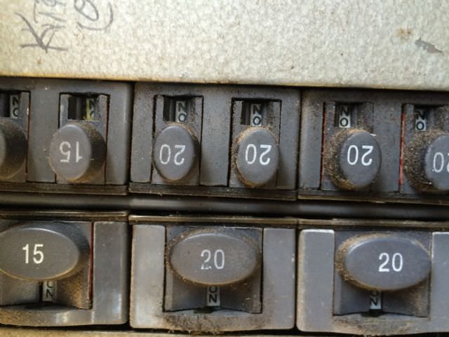

BillSkinzFifth Posted April 5, 2015 Report Share Posted April 5, 2015 I just joined this forum in hopes someone here can identify these breakers on my house. I need to order a new one and don't know what they are called or really how to identify them without having an electrician come out. Our house was built in 1957 if that helps Thanks in advance jEFf Click to Enlarge 57.39 KB Quote Link to comment Share on other sites More sharing options...
Trent Tarter Posted April 5, 2015 Report Share Posted April 5, 2015 Looks like possible ITE or Bulldog Pushmatic breaker. Do you know what brand of panel it is? Quote Link to comment Share on other sites More sharing options...
BillSkinzFifth Posted April 5, 2015 Author Report Share Posted April 5, 2015 Thanks for the reply. I just went out and looked under the lid [had to contort myself a bit as the logo was upside down and lid doesn't open a full 90 degrees] but it looked like it said Bulldog Pushmatic so I'd hazard a guess that you are correct. I didn't realize there would be a logo under the lid Thanks for the info!!!! [:-thumbu][:-thumbu][:-thumbu][:-slaphap[:-slaphap[:-slaphap Quote Link to comment Share on other sites More sharing options...
John Kogel Posted April 5, 2015 Report Share Posted April 5, 2015 Bulldog Pushmatics were generally considered to be a good quality breaker in their time. You can still buy the breakers on eBay. Be aware that old used breakers will not give you the same protection that new breakers do. Breaker technology has advanced a lot since the 50's. You should get an electrician to check out that panel and the rest of your wiring. Quote Link to comment Share on other sites More sharing options...
Speedy Petey Posted April 5, 2015 Report Share Posted April 5, 2015 Definitely Pushmatic style breakers, but I have never in all my years seen oval ones. Very interesting. I am very curious to see what the actual breakers themselves say on them. Quote Link to comment Share on other sites More sharing options...
BillSkinzFifth Posted April 5, 2015 Author Report Share Posted April 5, 2015 Definitely Pushmatic style breakers, but I have never in all my years seen oval ones. Very interesting. I am very curious to see what the actual breakers themselves say on them. I do have plans to have the place completely rewired at some point but I have a single breaker that does pop all of the way out when tripped and switch the lettering to 'OFF". The breaker DOES cut the power, And you can feel the difference when pushing it in and out that it's engaging and releasing. it's just the button doesn't pop out making it readily apparent that that particular breaker is off. All of the other ones will switch the lettering from "ON" to "OFF" as well as expose red lettering on the side of the button that says "OFF" Quote Link to comment Share on other sites More sharing options...
